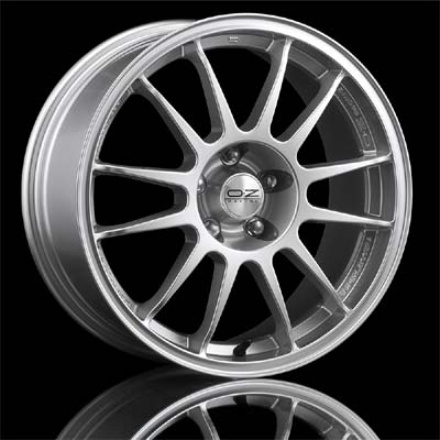

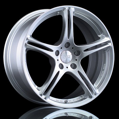

I would like to choose one of the following for my Track Wheel from TireRack , wraped with S-03 tires, Any of these better for track with BIG Brakes, I currently have 17" Centerline Excel (+40 offset)with a 5mm spacer for them to clear Wilwood Brakes. (will these fit?!?)
1. Kosei K1 TS 17x7 (+42 Offset) (14.1 lbs) 199$ per
2. OZ Superleggera 17x7 (+37) (16.3 lbs) 280 $ per
3. SSR GT1 17x7 (+45) (16.5lbs) 249 $ per

The first one 'appears' to offer the largest pocket behind the spokes for caliper selection.

The T1-S spokes are thicker than they appear in the picture.
My vote would be for the Superleggera for most brake clearance.

Ok, now I'm confused...
I'll vote for the SSR. Given it seems to generate more pocket at the spoke to rim area.

i was looking at the same kosei and the same SSR's so i could fit Todds big 13" kit. i just got the SSR's in white (199) two days ago. the kosei's were lighter but the SSR's in writing have a more solid construction. also, the SSR's are on close out and a few months ago those same SSR's where in the high $300 range. the reason i got the white is because they are $50 cheaper. i do have the white roof and mirrors so i think i can pull it off. these are just track tires for me. so i don't have to clean them all the time.
alex@tirerack said both the kosei and the SSR's would fit the big brake kit from todd.
