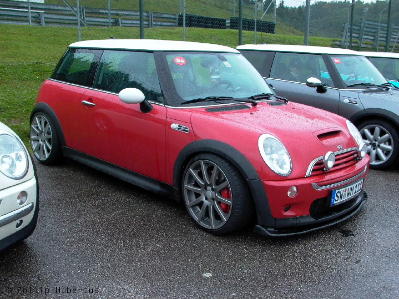

We have the same taste, I was considering the Superleggeras until I stumbled upon the TZ-10s. I originally liked these Binnos but I can't find much info on them and they're probably heavy..
Originally Posted by JCW Driver
Some of the wheels I like are the O.Z. Racing Superleggeras, the Exel TZ 10's, the Axis Seven Mod and a host of others.
My wallet puts me closer to the level of Exel wheel more so than the OZ's at the moment.
Suggestions as to where to start research?

I like those wheels on the red mini you posted, alot. I especially like the front lip spolier, but I would never get out of my driveway! It scrapes as it is...
