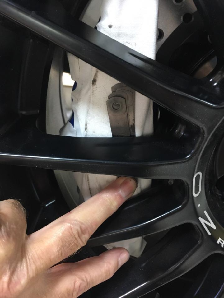

Okay - as some ( or most of you might have seen coming ) - I had fitment issues with my Enkei J10 wheels. These are monoblock calipers - so are thick. We tried 5 sets of wheels that Chuck ( https://mallettcars.com/ ) had in stock. My Enkei's did not fit, neither did stock JCW 17 and 18 inch wheels ( all up to a 10 mm spacer - we didn't have any larger ). However, Chuck did have a set of Sparco ( 17x7 ) , Oz ( 17 x 7.5 ) and some no name track wheels ( 17 x 8 ) that did fit ( no spacers )
Sparco Wheel mounted
OZ wheel mounting - showing gap
Track tire mounted - also showing part of the pile of wheels we tried on the floor
. So I switched to the Sparcos ( used - but powder coated in gloss black. About 18 lbs - so just a bit more than J10s ).

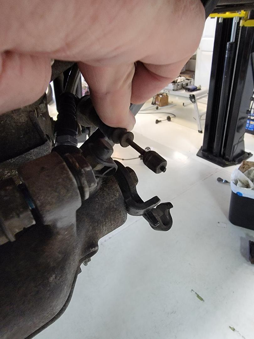

Issue 2 - again, I am sure some of you saw coming. By using the larger rotor in the rear - our ebrake line was to short - by about 1.5 - 2 inches. However, we were able to re route the lines get them to work
