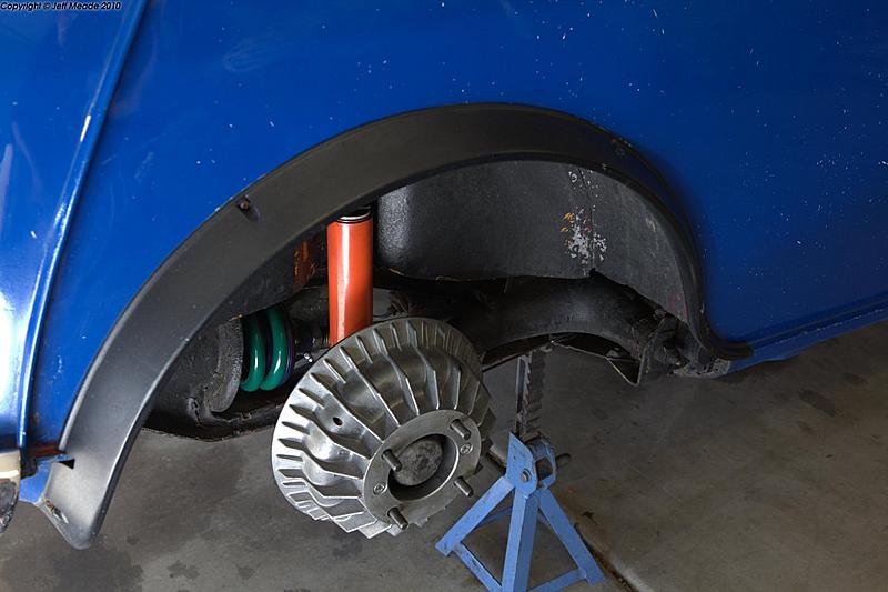

Hi all --
I've spent a few weeks going through the suspension and brakes on my '73. I replaced the front MG Metro brakes that the previous owner had installed with KAD 4 pot billet brakes that fit 10" wheels. I also installed a set of Fortech green springs to replace the _original_ rubber cones. I hope you like the attached pictures.
If anyone's interested on the MG Metro 4 pot brakes (including the necessary hubs and drive flanges) let me know. I can provide pictures.
Cheers,
Jeff
Attached Thumbnails New springs and front brakes installed-kad_brakes_atlock.jpg   New springs and front brakes installed-kad_brakes_straight.jpg   New springs and front brakes installed-fortech_green_springs.jpg

To which brakes are you referring, the KAD brakes (pictured in my original post) or the MG Metro brakes? Both have 4 pot calipers.
For reference, I'm attaching a couple of pictures of the MG Metro brakes before I pulled them off my Mini. I think this is the kit on the MiniMania website. http://www.minimania.com/web/Item/GS.../InvDetail.cfm

Nope ... 12" is the smallest. I tried to fit a set of 10" Minitors and the calipers are _just_ the slightest bit too big. That's why I replaced them.
