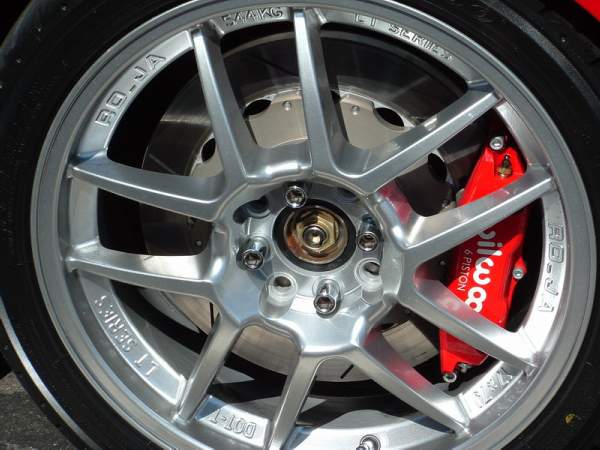

I have the 6 piston ones.... still waiting for the rears....

I have the 6 piston ones.... still waiting for the rears....Attached ThumbnailsWilwood big brake kits-wheels.jpg
Did you paint them yourself? What size wheels are these? Did you need spacers? These BBK is the one I am thinking of getting.

They come that way. size 17" wheels and 3mm spacers on these particular rims
