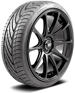

215/35/18's (24.02" dia) ride noticeably rougher than the 205/40's (24.53" dia) ... In the same tire for the two sizes.
Nitto Neo Gen's in my case....also, I found that in the rain... the 215's would not corner as well.
They also offer a 215/40/18's (24.76" dia)... which would be a good fit also.... Unless you are a "track star" ... you won't notice any difference in handling compared to 215/35.
Wheel protection is also an issue in the real world... with shorter tires making a big difference.... just a bit can mean the diff between a bent wheel and not.
I'm a big fan of the Nitto Neo Gen tires...All-Season UHP tire, UTQG of 280 AA A.... great grip, great price and very good 3 season performance (no snow)... is decent in the cold dry tho.
Americas/Discount/Simple tires all carry them. Nitto is a quality Japanese tire IMO with tight quality control. If you are into the name on the side of the tire... decent choices in the Michelin tires.... but unless you are a super aggressive driver, IMO, the 4S will not make a difference to most.. and you compromise in other than summer conditions.
