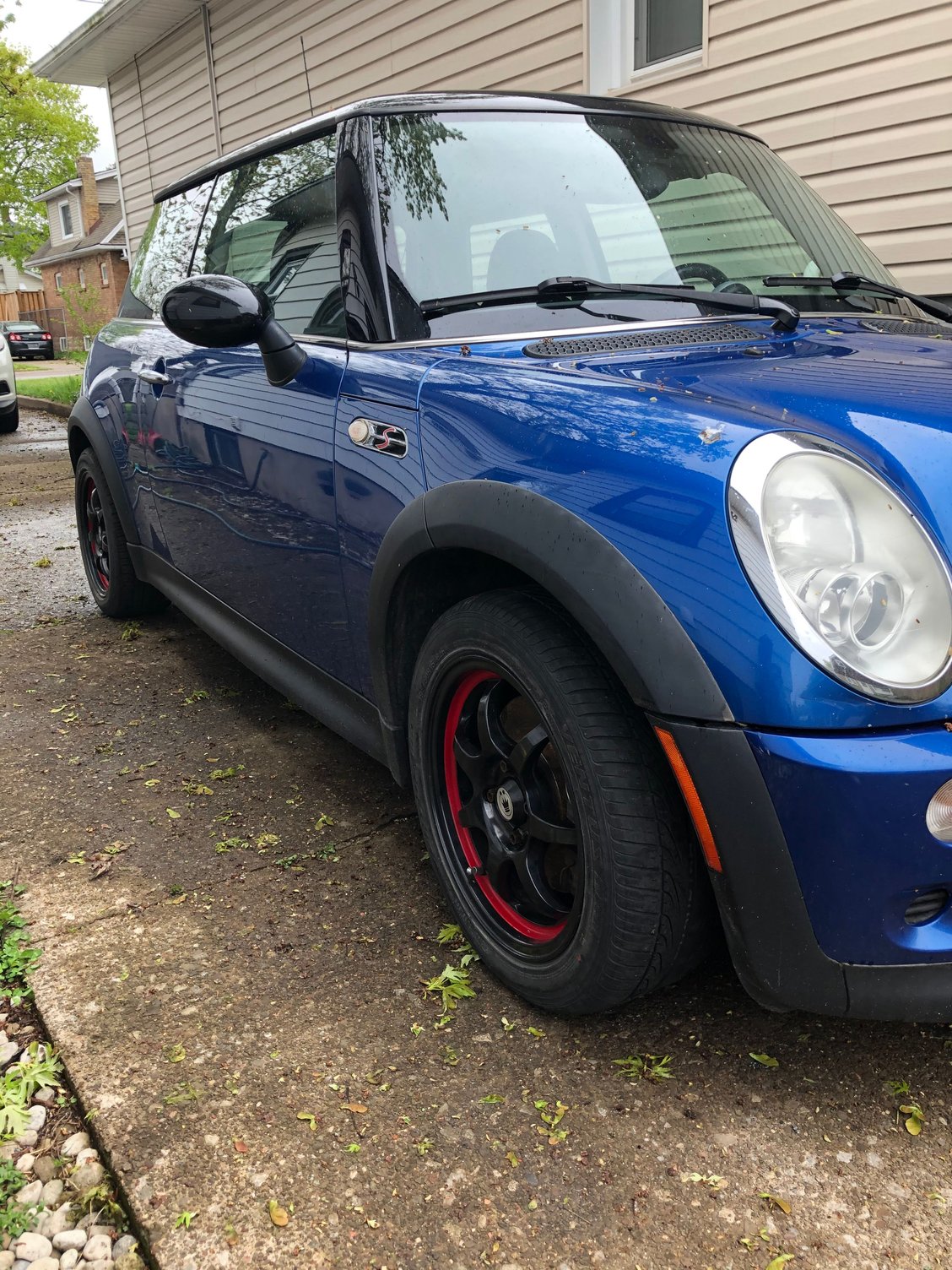

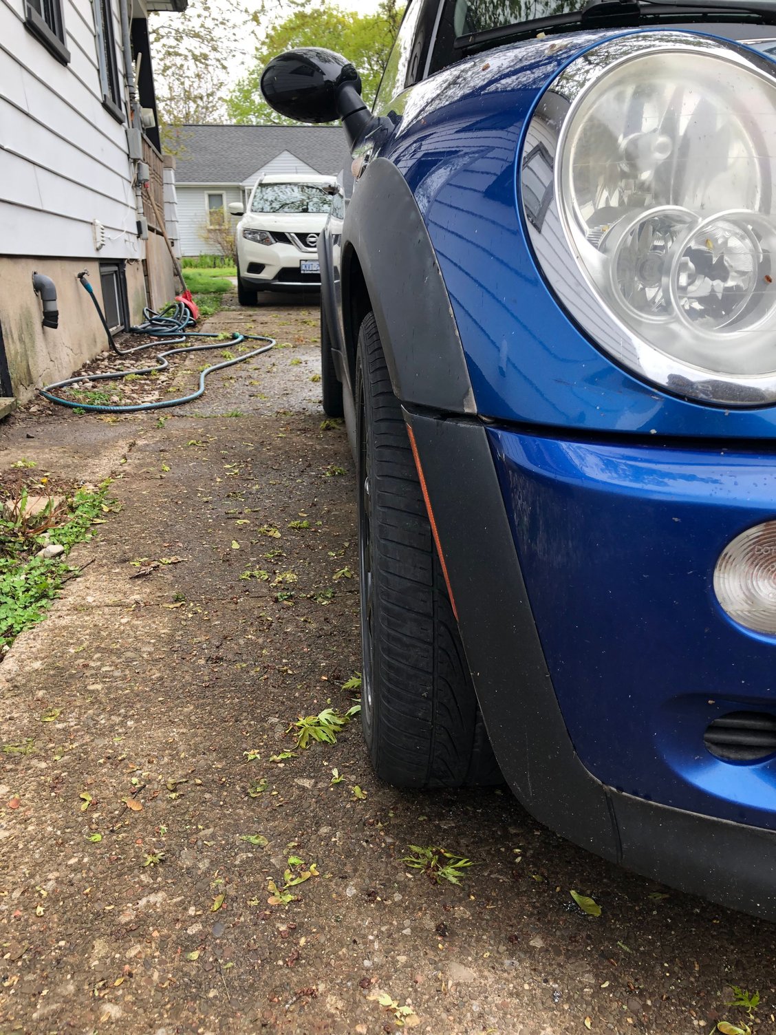

So I tried the rims to see if they fit, they do. The 15s currently have 195/50 on them from the last car, I know it’s too small just wanted to get an idea what they’d look like/ see if they fit over caliper. Here’s a pic, it’ll be better with proper size tires but here’s an idea. So would a 205/55 tire be a better performance tire compared to a 195/60 then?

205/55-15 is not a good choice due to very limited tire selection.
For those rims, 195/60-15 is OK if you are only street driving. Then look at Grand Touring All Season tires. Otherwise for performance Street driving then try 195/55-15 which is a little small on tire diameter but OK.
195/50-15 is very small for tire diameter, wheel gap is very large but it still works in a pinch. I have run that size for limited street driving, they were race tires for track events.
