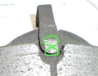

If you have a worn/triggered sensor ... look very carefully at the end that was in contact with the rotor face and in the black plastic you'll notice two metal spots ... the remains of where the wire was ...
this is a GEN2 but they are similar ...
