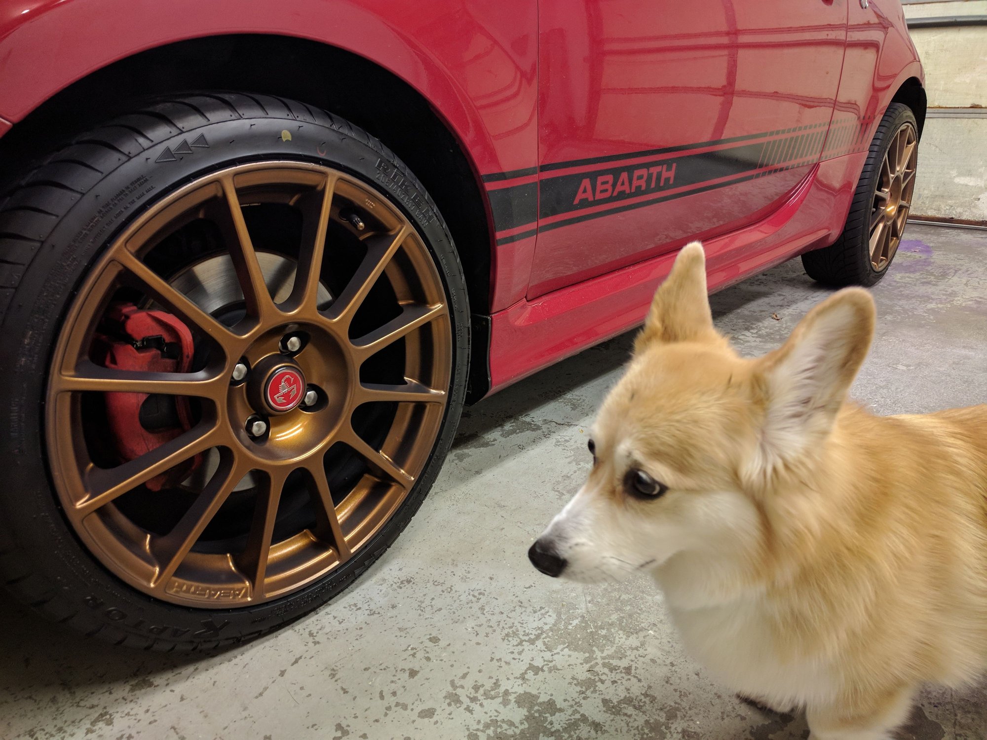

Originally Posted by Scypio
I plasti-dipped my hood scoop and made a fake "JCW" grill on my MCS. It makes me want to do my wheels, but I'm not sure about the color.
Love the grill addition, looks factory.
Let's pick out your new wheel color together! What MINI wheels do you have on your car?
Here's my favorite dip job (and my dog).
Bronze wheels, unimpressed doge

Thanks and those wheels do look nice; dog looks confused.
My wheels are 17" factory, black "8 spoke" wheels (I think I read them called that before). Black version of SLO-MCS's wheels.

Hmmm. On a dark grey car? A safe choice would be a hyper silver, something to emulate the light OEM alternate version of those wheels. If you like the dark you could explore a black with color pearl built into it. My current dip is "Obsidian Black" which is black with a little purple pop in direct sunlight. A blue version of that might be safe yet interesting. (I'm pretty much describing the new MINI Yours "Enigmatic Black" now that I think about it.)
