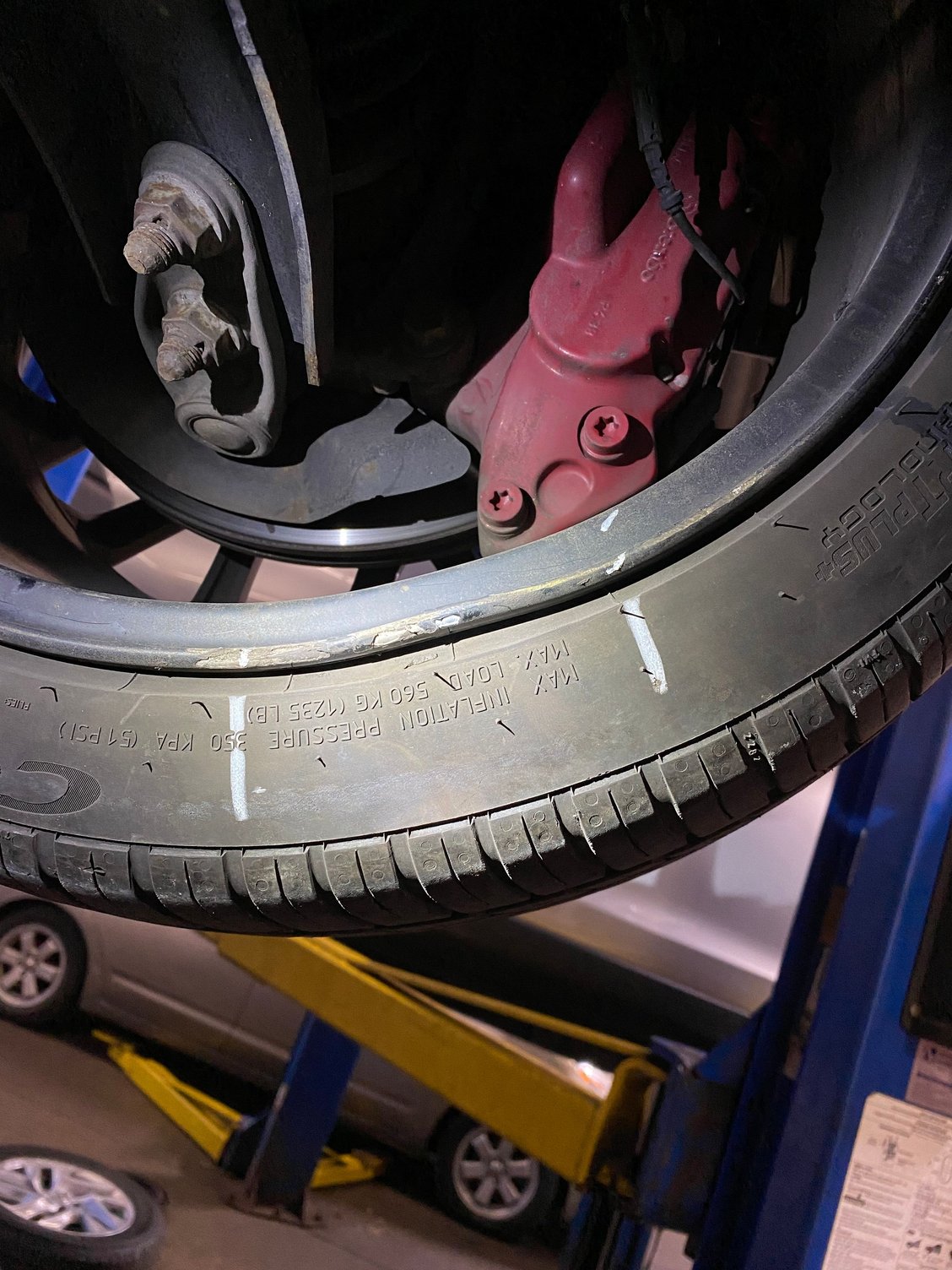

Left front
Right front
So I live in Chicago and we have potholes everywhere year round. Normally I’m great at avoiding but this time I couldn’t get around it. Not sure how the damage is only on the inside of both my wheels but I had a bubble in one tire and the shop pointed out the bend in my rims and suggested replacement. What do you guys think? Are these salvageable or do I need new rims? I did notice a little vibration in my steering column since and the front tires both have less tread left than my rear.
any input would be appreciated, thanks guys

Posts: 36,768
Likes: 2,553
You would have to take it to a wheel specific guy, it looks like you could save it, but they have to look at it as that's what i did with mine. Also you have a small clunk out of the one tire. I would have them look at that also. Some large chunks are not safe to drive on.
