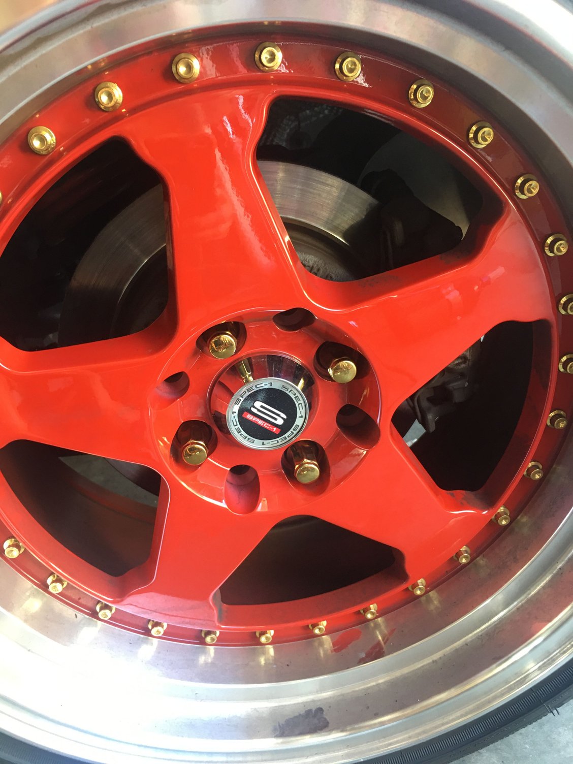

This is what i have right now and i have some room left. Is 53 the total length?
Old Oct 30, 2019 | 09:29 AM
Serafin's Avatar
Serafin
Joined: Oct 2018
Posts: 835
Likes: 90
From: St, Petersburg, FL
There should be enough room. 56mm is around 2.2” lug nuts seems tall

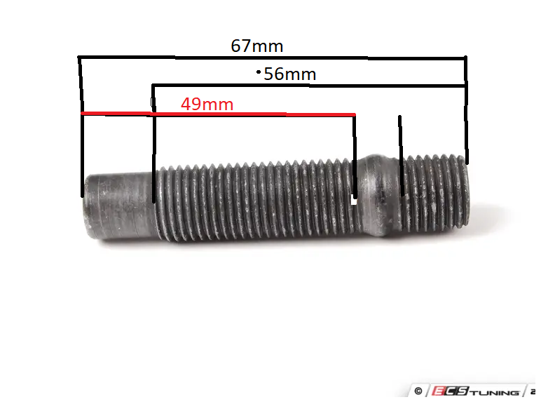

Stud length 67mm total, 56mm is the total thread length(wheel and car side), 49mm thread length on wheel side(shank length)

This will work then because the rest of the thread will poke out and stopper is there. Correct?
Old Oct 30, 2019 | 10:32 AM
Posts: 36,768
Likes: 2,553
So you have to make sure that your end cap nut goes into the stud enough to make contact and seat on the wheel, but does not bottom out on the head of that cap. Also it has enough thread engagement (dont want to be held on by 1 or 2 threads), 7 turns(threads)to be safe. This is with the stud installed and torqued down. I dont have that measurement. You would have the measure that. When using aftermarket wheels and then aftermarket lug cap nuts, it want to make sure its safe and correct. =
by e way 56mm + 49mm is 105mm not 67mm.
you sure you got the right measurements?

Old Oct 30, 2019 | 11:19 AM
Posts: 36,768
Likes: 2,553
Just posted more info above.
Here is a picture with the measurements for you on the studs for stock size.
Old Oct 30, 2019 | 11:42 AM
Serafin's Avatar
Serafin
Joined: Oct 2018
Posts: 835
Likes: 90
makes more sense. Thank You and it’s the first one on your link. The one that can use 10mm wheel spacers
Old Oct 30, 2019 | 11:52 AM
Posts: 36,768
Likes: 2,553
Yep, welcome. Yes.
