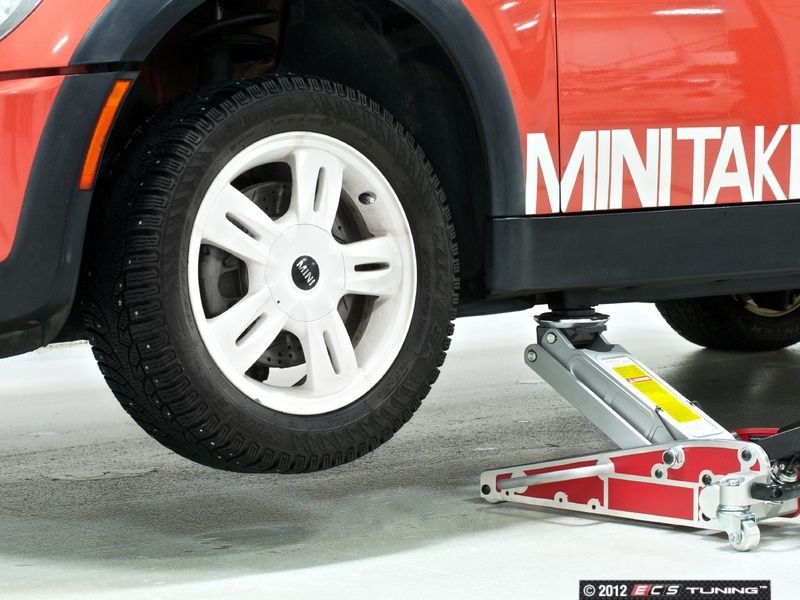

instead of getting 225/45R18 winters, i would suggest a second set of 16 inch wheels and going eith a 205 width tire
the narrower tire gives better penetration in snow and a 16 inch size allows a taller sidewall for better pothole survivability
i am using mini oem alloy wheels i bought from ecstuning.com and 205/70R16 dunlop grandtrek sj6 studless ice and snow AT (all-terrain) tires
i have gone head to head with ws80s and the dunlops have more traction AND they are only $83 each!
i am on my 4th winter plus a bunch of summer offroading on my dunlops and will probably get 1 more winter out of them
+1 The 16" by far would have the best ride and high side walls for the dang pot holes.
