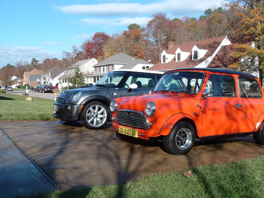

a MINI next to a Mini ..... they are DIFFERENT
as a biMinual it matters to me . . .

What a great picture.

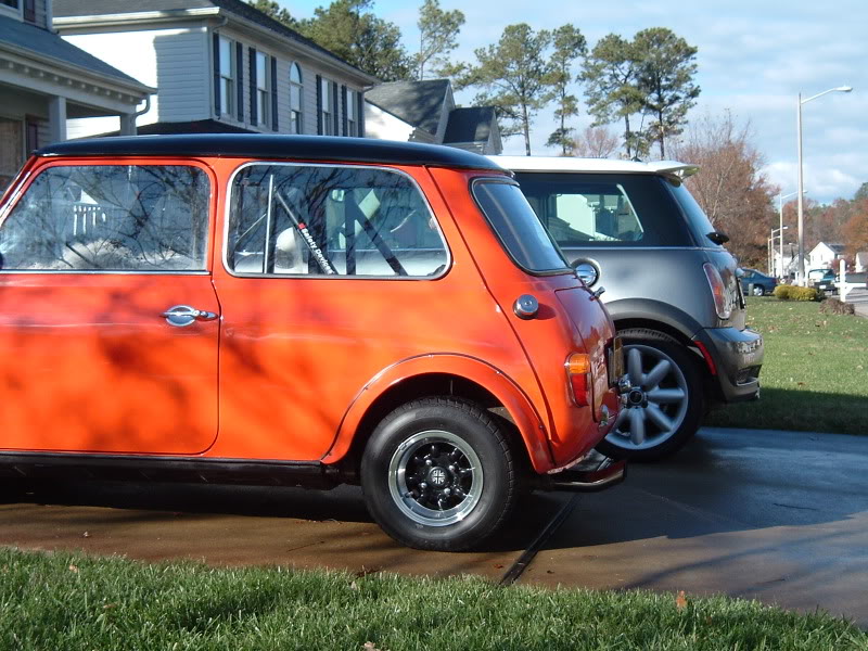

cute butts too

P.S. Love the orange Mini, Capt_bj. Not sure I'd be here today (asking questions about MINI tires) if not for Mr. Bean.
