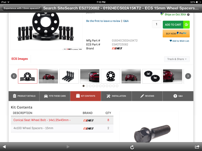

Originally Posted by BossyR56
With the ECS kit what is the thread size on the studs?
This. And I am running theses on stock wheels also and love them. Experience with 15mm spacers?-image-646445318.jpg Sent from my iPad using NAMotoring

Originally Posted by Drivehard
This. And I am running theses on stock wheels also and love them. Attachment 116014 Sent from my iPad using NAMotoring
Yes. Thats the length. Looks good in 15mm.
