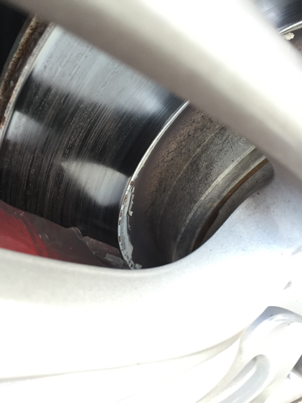

Does anyone know if this is normal? Did a track day today. What is this substance flaking off? JCW rotor finish flaking-image-489202748.jpg

It's a little hard to tell from the pics, but it looks like some paint coming off the rotor's hat. I don't know if your R58 rotors were painted white, or if the paint discolored with heat, but as long as the surface of the rotor is fine and not warped, they are good.
All rotor hats rust (as do surfaces if the car is not driven for a while), and higher end rotors pre-emptily paint them. Either way, it's a cosmetic consideration that has to effect on braking efficiency.

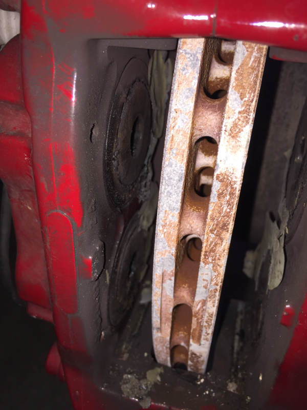

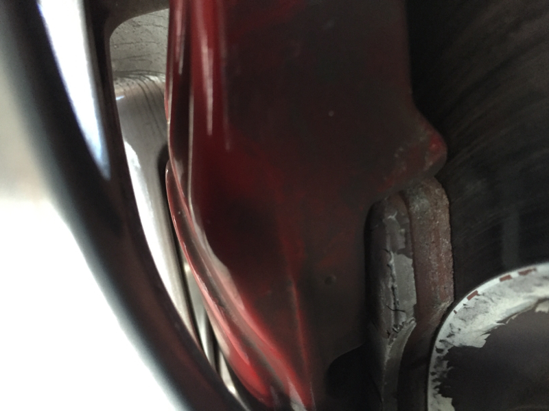

Ok finally did some investigation. Seems that I disintegrated my dust boots (I think) and possibly the backing of the brake pad? maybe cooked anti-squeal compound too? Dunno. Pads look fine. The crap finish on the rotor seems to have been compromised too. I don't care because I didn't have any fade at all. Mission accomplished! JCW rotor finish flaking-image-2642113893.jpg JCW rotor finish flaking-image-2400252675.jpg
Pads are fine, but the paint has warped off the backing plates. No big deal.
Add some more anti-rattle goop to the back of the pads, and put them back in.
Many pads manufacturers throw a few packets in with the pads.
If you don't have extras lying around, add this one to your next parts order from BavAuto (or similar):
