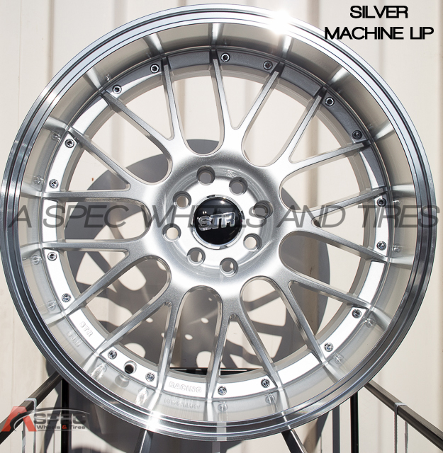

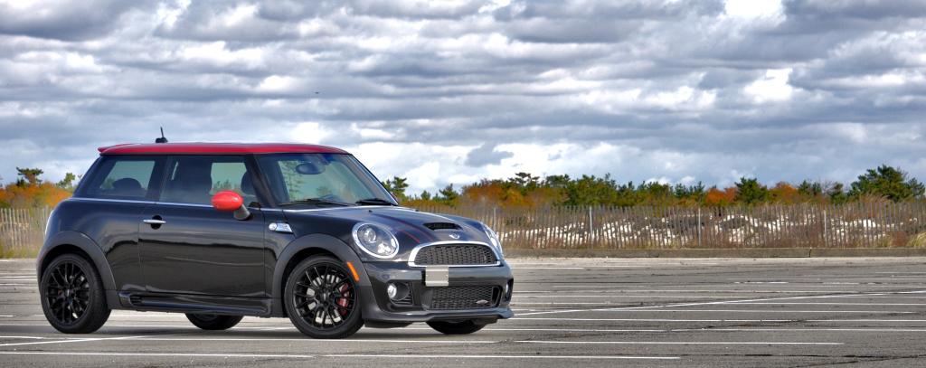

First, I'd like to apologize if this has been covered before. I tried looking it up but came up short. I have a 2012 JWC and wanted a set for the summer and was thinking between the STR 514 18x8.5 +30 offset or the Work VS-xx 18x7.5
Would any of these two fit the car? Thanks for the help in advance.
Here's my car as it looks now

Here is the STR in question

As far as Tirerack recommendations, the et30 will be an aggressive fit. I am sure we'll get some owners chiming in with these lower offsets.

STR 514 in 18x8.5 et 30 compared to OEM 17x7" et48 wheels will be-
http://www.willtheyfit.com/index.php...et2=30#content
1mm closer to inner suspension
poke out 37.1mm more which is a lot
Use either tire size-
215/40-18
245/35-18
See pics in post #8
