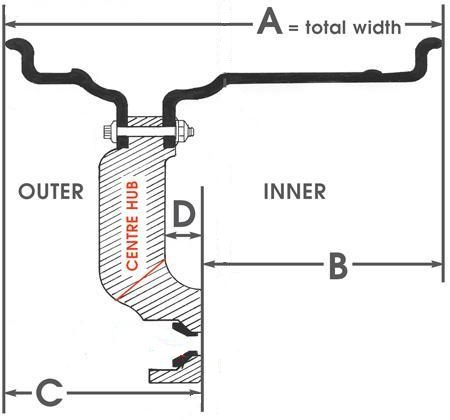

So I'll be buying in summer a set of 3 piece custom made wheels from England. Dimensions are:
17x8.5 et 30 in the front
17x8.5 et 25 in the rear
(anybody with similar dimensions and offset post your pics for comparison)
Upon asking the wheel makers their max size lip for the dimensions of my wheels I want, they want the dimensions of "D": refer to image attached.
I told my friend, he gave me this sheet: http://www.ccwheel.com/documents/BrakeMeasurements.pdf
Which dimension does the wheel maker want? I have no idea what the stock caliper dimensions he wants are. If anybody has them handy, please post.
Also, I will be lowering my 2006 r53 over 2 inches with these wheels on ST coils. Any fitment experts on here, could you tell me the range of danger in rubbing coils/brakes/anything else? Do you think my sizes are safe?

I like the CCW wheel measurement doc that you linked to. If you give those measurements to the wheel company they can figure out how much clearance your current brakes have. Front calipers are larger than rear brakes. You have the opposing piston caliper type.

Thanks much for such a detailed response. I do not have the STs yet. I also live in New England. Bad roads, but not as bad as Massachusetts. I'm in New Hampshire. Everything you listed was what I was expecting which is good, that means I'm not totally clueless yet. As far as the offset, I'm trying to get pretty close to flush. You mentioned my rear wheels will be about 42mm outwards. Compared to stock wheels that are pretty tucked in, how close to flush do you think this is? Also, I intended on definitely getting stretched tires for clearance. I was thinking 195-40-17. Camber plates were a thought as well.

It is correct that the OEM wheel is not flush so that poking out is not as drastic as it might seem just from the difference I quoted. Roughly it will poke out 1.65 inches = 42mm.
