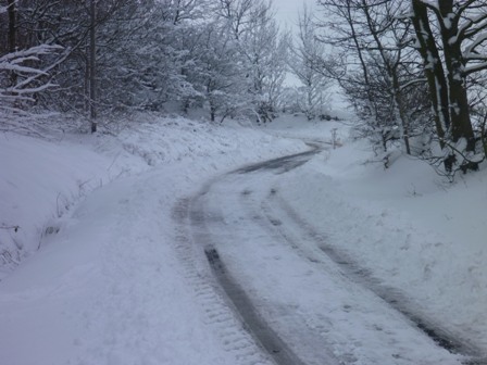

If you ever have to go up a steep hill with insufficient traction, in a front-wheel drive car you will do much better in reverse, when the gradient of the hill is pushing the car's weight onto the driving wheels.
Of course, you may look stupid - but then whether that matters depends on how much you want to go up the hill.
Here's an icy 1:6 (I think that's measured as 16% in the US) that my Mini went up in reverse last winter.
In a Roadster this was not at all easy, since the rear vision is so poor that I couldn't see where the bends in the road were!
