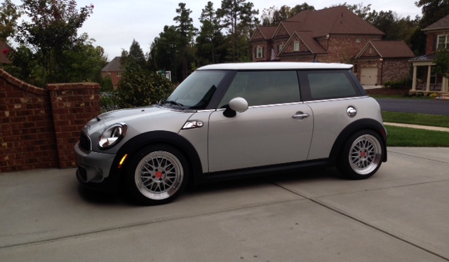

Update: After reading more on the topic, this is what i ended up with. the car rides well and is a blast to drive!
Looks good. What are the specs on the wheels?

The wheels are esm-004's 17x8 et35, I bought them on sale direct from the mfg's website.
