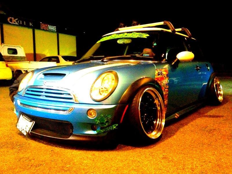

I'm guessing this is a typo and the OP actually meant 16x8 et8 and 16x9 et15.
Doesn't matter either way though these won't work unless you want to run tons of camber and go for this look:

^^^^This IMO is just dumb. ^^^^ Please can someone tell me why they think this looks good?

No one said they think it looks good.
Thats why asked for someone to tell me why it does. LOL
