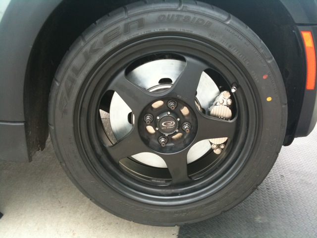

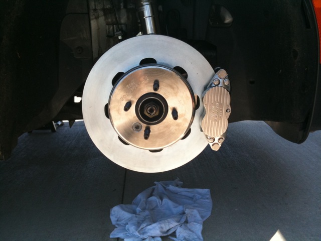

Have any pics of the brakes and with the rim on?
1st: 16 inch rotas, what I use on the street
2nd: without wheel
3rd: 3rd: 15 Team Dynamics, track setup
