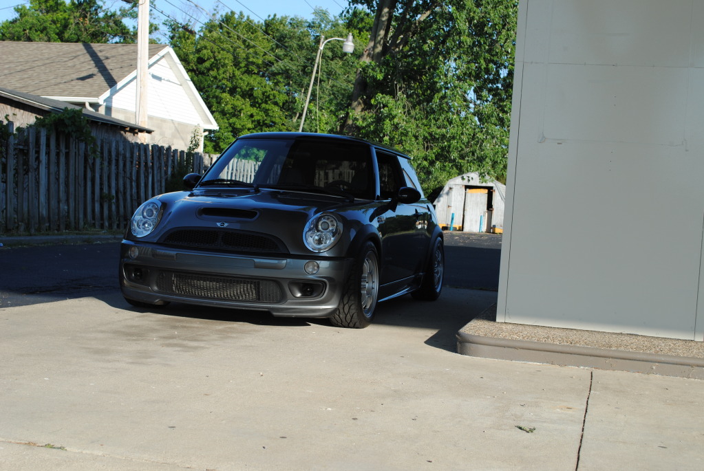

Ill be happy to help. I am running the 16x8 38 with a 225/45/16. Fits just fine on the inside but will rub. I had to do some clearing to make them work. 215s will work a little better.

To be more specific for you. I had to trim the front arches, just the ones assigned to the hood. I had to trim the rear arches both on the body and the rear bumper. Also had to trim the rear fender liners.
Depends on how low you are honestly. If you do not plan to tuck under the arch you should not have many issues.

very helpful, thank you. So its mainly just trimming a few of the arches? No problems with the tire rubbing the body of the shock? I actually work at a body shop, so trimming and stuff is fairly simple and second hand nature to me. My main concern was if the rim and tire combo i wanted was going to be too wide for the shock bodies. Thanks a lot, i appreciate the help. Car looks great btw

I'll post more later. But no shock issues at all in the rear. I run a 5mm up front though.
