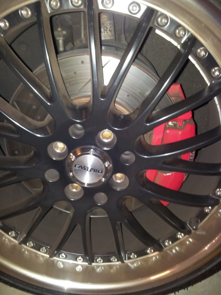

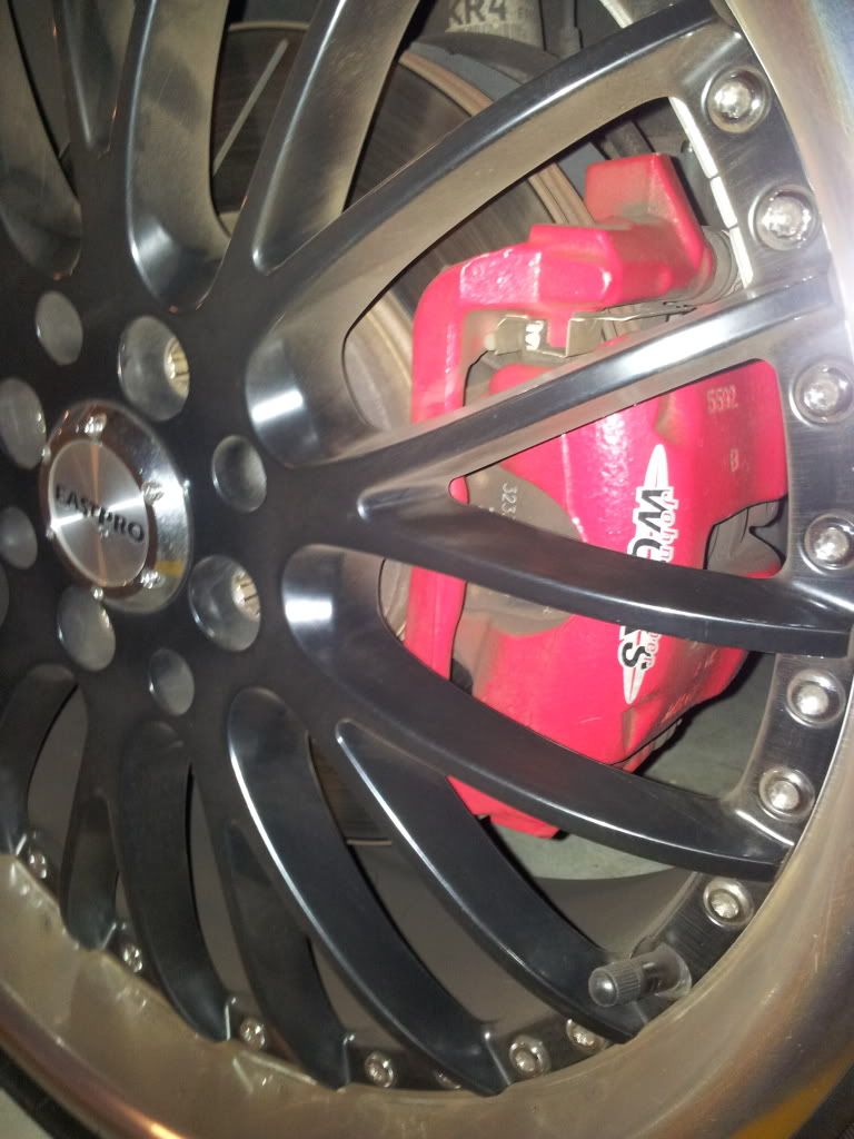

Hi ,
When I got my car I was given a free set of JCW front brakes because my car was delayed for so long. When I got this car the factory JCW didn't even exist so i know I don't have the brembo JCW brakes (also I have seen the massive brembos). My question is What brakes do I have?
I need new pads soon but everywhere I look i can only see the Brembo JCW pads or stock S pads. Do I just have a tarted up version of the stock S brakes? If so do I just get S pads? I was thinking Hawk HPS, I only drive on the street but hard.
Thanks.

Looks like Brembos too me. Those do not look like my stock S brakes.
On another note can you edit your post and put the second picture below the first one so that it is easier to see your post? Thank you.

i got my car in january 2008 so the JCW car wasn't even around so i don't think they would have had any of those kits. i have seen the jcw brembo up close in the past and i think the discs are slightly bigger and the calipers a fair bit bigger than mine. im thinking mabye they just stuck on a JCW kit from a r53???

Those look like the brakes from an R53 JCW, which are the same as the R56 S brakes. These are really good brakes for the street and needless to say, look sharp. Personally, I would go with the Hawk HP Plus. More bite and heat tolerance than the HPS. A little bit of squeal when stopping but I didn't mind that. The HPS are a bit better than stock brake pads and a little less dust.

thats what i thought, thanks Eddie07S. i will grab those pads too thanks.

thanks Eddie. It turns out I have the JCW sport Brake kit which is just the red claipers, slotted discs and harder pads than standard r56 S.
