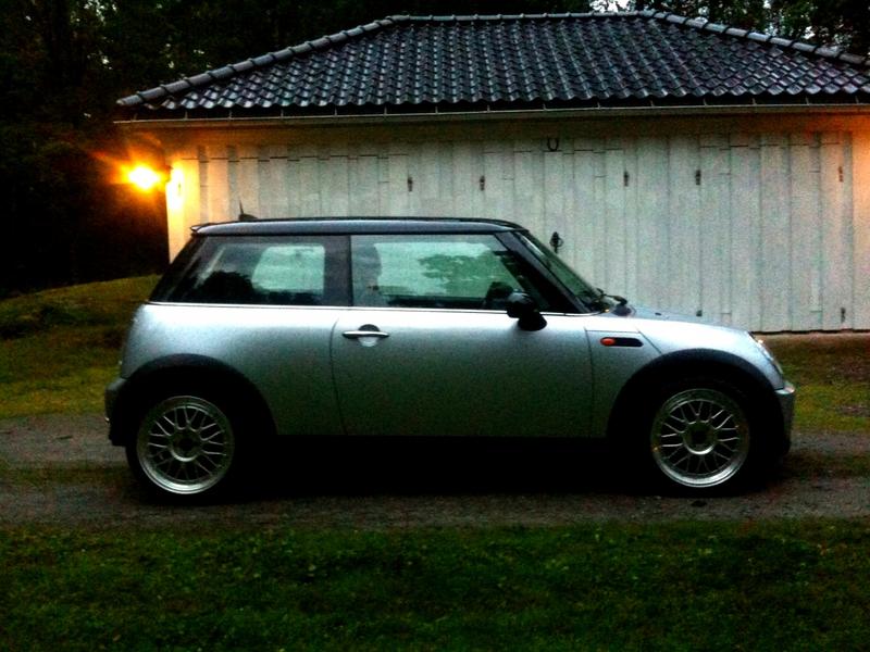

Thank you very much for this. Judging from the picture this looks absolutely perfect. Will upload photo when I get mine.

Attached Thumbnails BBS LM Replica question-rim11.jpg   BBS LM Replica question-rim22.jpg   BBS LM Replica question-rim33.jpg
