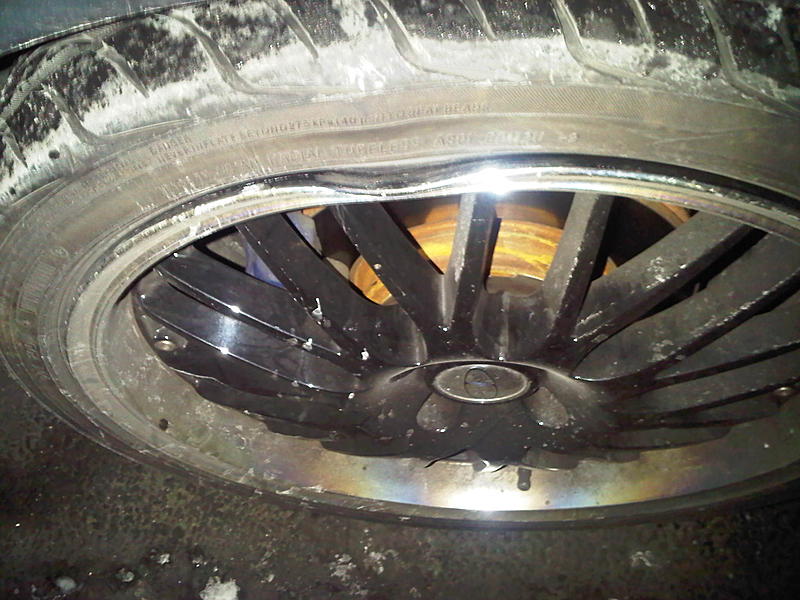

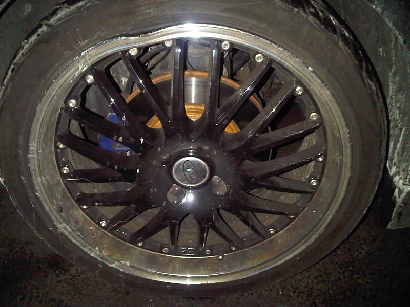

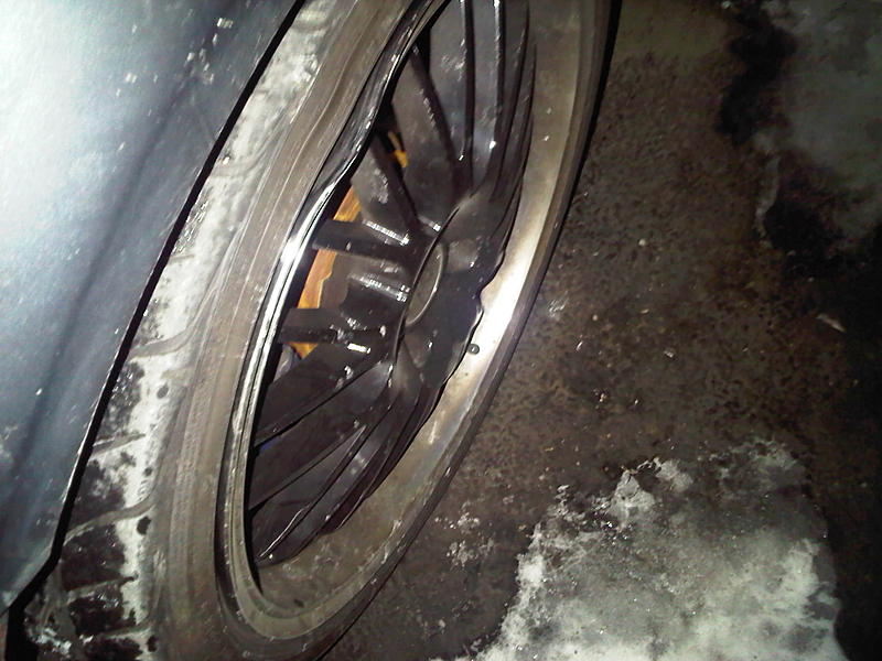

here they are, excuse the filthiness
Attached Thumbnails Bent Rim-stamford-20110124-00020.jpg   Bent Rim-stamford-20110124-00021.jpg   Bent Rim-stamford-20110124-00022.jpg

Based on the first pic you do need a tire... It looks like a little bulge which means that the belts broke inside. If there is no bulge at all, I wouldn't replace the tire.

looking again at your first picture I'm pretty sure I see a bulge too. Good catch iwash...
that tire is dangerous to drive on. It is very ready to blow.
