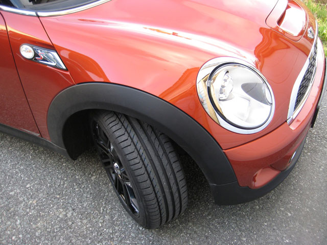

I bump this to show the end result. I ended up with the Enkei GW8 in 17x7. The tires are Conti SportContact 5, dimension 215/45 R 17.
As you can see the triangles are chromed, which actually looks quite nice. But I also got the red ones which I will paint in the cars color (Spice orange).
The wheels and tires were a great fit and a smooth ride. Only problem I had was that the standard mini wheel bolt wrench was too wide to use on the narrow holes on the GW8, so I had to get a replacement wrench.
Thanks to every one who contributed to this thread!

Old Apr 28, 2011 | 12:04 PM
ososinsk's Avatar
ososinsk
Joined: Apr 2011
Posts: 6
Nice!
The spice orange looks good with the black. I think it'll look even better when you paint the inserts.
