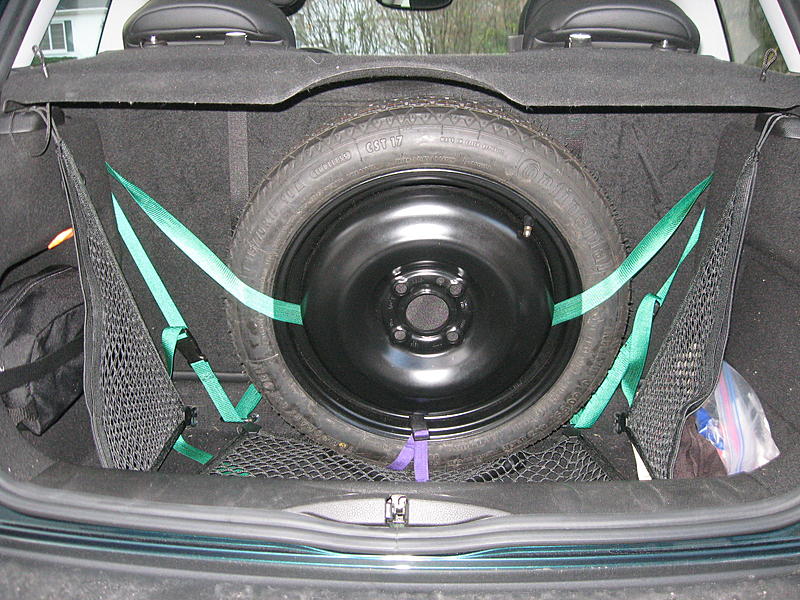

RF MINIs do come with a jack. And we do have to suffer a little on storage if we wanna carry a spare --
I got rid of the RFs, went with Bridgestone Potenza RE960AS PolePositions, and LOVE them, even in the wet weather ... as for stashing the donut on road trips, I bought a stock donut and rigged it into the back with three nylon buckle-straps from REI: two six-footers on the sides between the seatback loop and the netting loop, and one two-footer looped through the seatback hinge in the center -- no rattles, $7 total. A small round jumper-cable-bag fits inside the donut center and holds my tools.
So you found a way to squeeze the donut into your car. Lets say you have a flat and use the donut. What do you do with the wheel/tire you removed from the car? Do you leave the wheel/tire, your luggage or your significant other on the side of the road. Just carrying a donut doesn't solve a flat tire problem.
Basil49,
This seems the near perfect solution. Is that a OEM donut and which diameter fits over the MCS brakes?
TIA

Originally Posted by Robin Casady
[OEM DONUT] only fits over rear brakes. So, if the front goes flat, you have to remove the rear wheel, move it to the front, and put the spare on the rear.
Robin is correct; OEM donut is a T115/70-R15 (36-111-509-164 rim + 36-120-418-847 tire), about $150 total with some agressive shopping.
