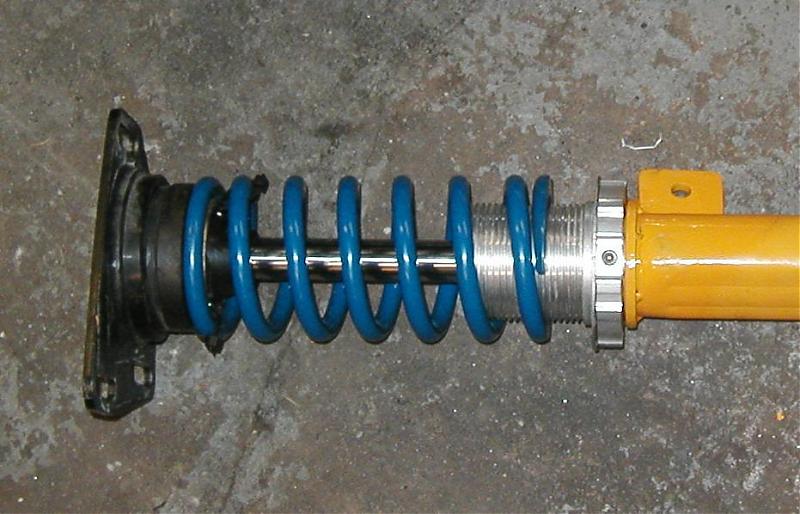

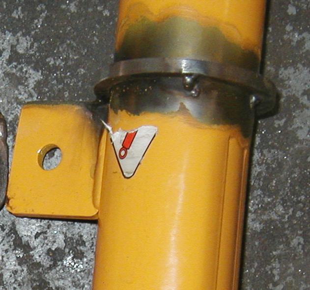

Front Konis: I did this with a ring tig welded on ( careful not too much heat) and a threaded sleeve added. I have been running these for the last year. I used H Sport camber plates and 2.5 " springs. Rear Konis are easier and straight forward.
Attached Thumbnails Adding coilover springs to Koni yellows?-p1210024-3-.jpg   Adding coilover springs to Koni yellows?-p1220038-3-.jpg

These should work but you will have to weld on some rings to function as stops for the threaded sleeves. See pictures in my earlier post in this thread and also the picture below'

No need to drain fluid. Use a tig welder and weld carefully it in 4 places see my earlier photos in this thread.
Sorry no pictures of the Koni's before the stock spring seats were removed. By the way these are easily removed by a sharp blow from a hammer.
