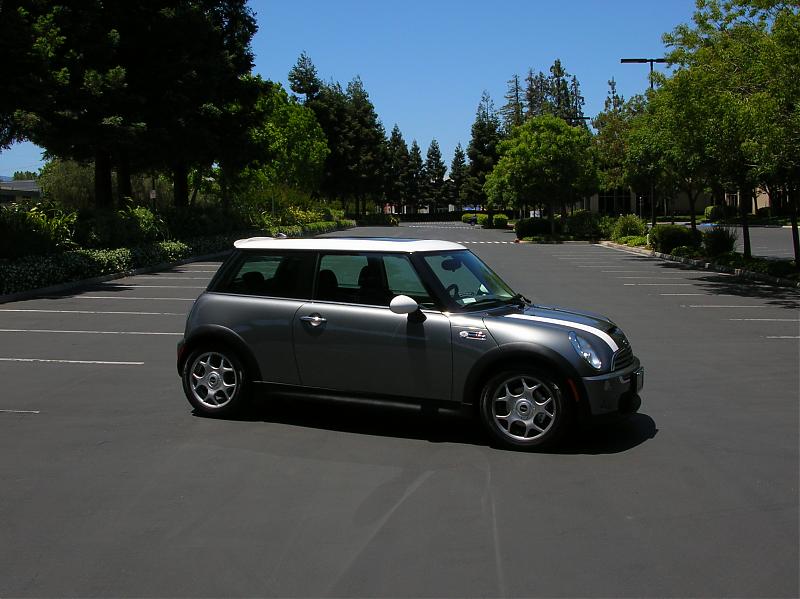

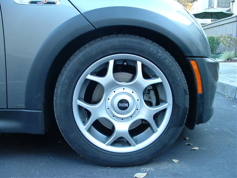

pictures of new texas speedwerks springs installed

Wow that doesn't look like much drop at all. I was hoping for a little more. I compared your pix to my car, same wheels/tires, and I can hardly tell the differance. You wouldn't happen to have a before pic laying around would you?

Once they settle in, you'll end up right around 5/8" drop in front and 3/4-7/8" in the rear...
