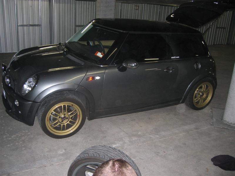

So...I'm going to try a few things out before I start throwing money at the problem....here's my first 'experiment' - the results weren't surprising....
Tonight I swapped my wheels with a mate here - and put his enkei RPF1 17x7 wheels on my car. The tyres are are 205/45/ZR17's and are on their last legs, but are *just* still road-worthy...good enough for this experiement anyway.
I took the 18's off my car and weighed them - 20kg with the tyres on - that's 44 lbs...
The enkeis, with tyres, weighed in at 15 kg - 33 lbs.
So....at least it was a reasonable difference...
Well....the first thing I noticed that the 'pick-up' intially was quicker - ie. how quickly the car responded to me mashing my right foot down - it was noticably better.
We took the car down a straight strech of road and tried some 0-100km/h times (close enough to 60mph-ish).
NOTE: Believe it or not, I have never tried this with any car I have owned. So, understandably my launch 'skills' leave a bit to be desired....and therefore my times are pretty slow...
18's:
8.7 sec
8.7 sec
7.9 sec
8.4 sec
avg: 8.425
17's
8.3 sec
7.5 sec
7.9 sec
7.6 sec
avg: 7.825
now...I know this isn't very accurate...but they did *feel* like they accellerated quicker...
Also....I understand that the real benefit of taking 11lb of unsprung weight off each corner is felt more in the handling than the accelleration...
More importantly, in the context of this thread - the ride quality was vastly improved! Bumps in the road still registered when I went over them, but I didn't feel like stuff down there was at risk of bending or breaking! Accelleration out of corners is markedly better....
Like I said, none of this is surprising. I love the look of the wheels so much that I'm prepared to make some compromises. But if I'm comparing this new setup, to the one I just had - I like the driving experience of this one more....
Anyway...in a week I'm putting the 18's on a car with eibachs to see if there is any ride difference there....
oh yeah...see how the top three coils of the alta suspension are sitting against each other....I hear that is different to some of the other spring set-ups.....also....check out the tar-ox brakes...on the other car... (he's also running H&R springs)
