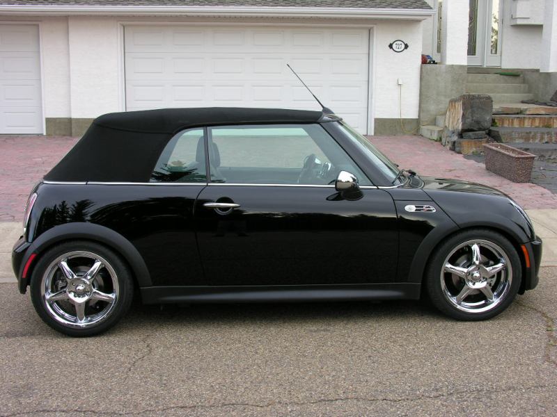

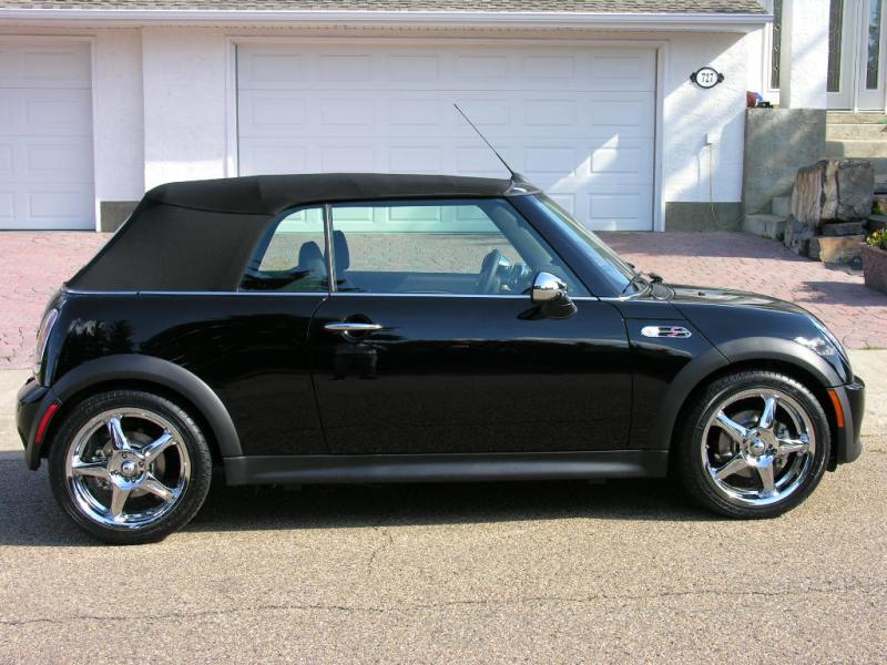

I finally got before and after pictures, the PSS9 are set to the highest setting per Bilstein's installation manual.
I now have the firmnest set to 9 and the ride is better than stock.
On a scale of 1 to 10, I'd give this upgrade a 9.5 over stock, I found the easiest way to set the front, I leave the dust caps on and put a mark with a pen on the cap and found that turning the cap will also rotate the dial, I also found that removing the cap, will change the setting when you try to reinstall the cap, so if you want a sure setting for racing, I'd say don't put the caps back on till your done racing, otherwise chances are you'll move the dial when trying to put the cap back on.
If you're worried the dial might mot turn with the cap on, put a small dab of silicone inside the cap and you'll never have to remove it again, just write down your own lines and numbers outside the cap and you're done.

Well, it took care of the gap as you can see, and it rides better on 9 than the stock suspension, so it has it's purpose on there too.

Anyways, how much heavier are the convertibles? your car looks pretty low even at the highest setting.

The convertible weighs 165 lbs more than the coupe.

I wonder how many of them have been set outside of the recomended range, I always say mine are at the highest setting but the truth is, it's the highest setting if I take the time to measure and keep it within the dimensions provided but there is more thread left and could go much higher but then I would be outside the the manufacturer specs.
The front shows 210mm to 230mm and I have them at 230mm and there is not much thread left, but the rears they range from 175mm to 195mm and I have them at 195mm but there is about 1" of thread above where I stopped, so it could go way higher, so I wonder why they do that, you would think they should make threads only for the allowed usable range, that way nobody would be able mess it up.
