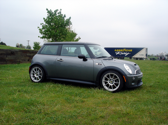

Originally Posted by fj0
Here is mine
Lookin' good. I love the painted trim.
Here's mine. Only side view pic I have handy...
