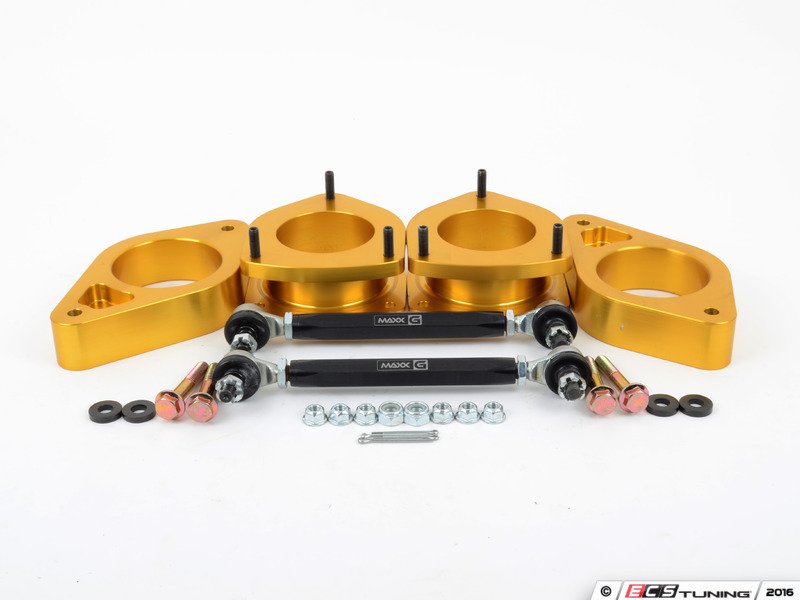

You can run the lifter M7 Speed R60 kit spacer version and Kit the suspension stock then go with a Bilsteins or KONI? Unless you really want the coilover set up to dial in. Some people will get stock coilovers from their favorite brand coilover and then you can dial down and get ones with dampening (with i would do). As far as lift over stock most aftermarket coilovers will go up a little like ~10mm over stock. But thats the most you will get in lift.
Then you can get bigger tires and get this set up below. https://www.northamericanmotoring.co...ntryman-2.html
https://www.northamericanmotoring.co...-2-5-lift.html
https://www.ecstuning.com/b-m7-speed.../c-suspension/
Hope that helps.
