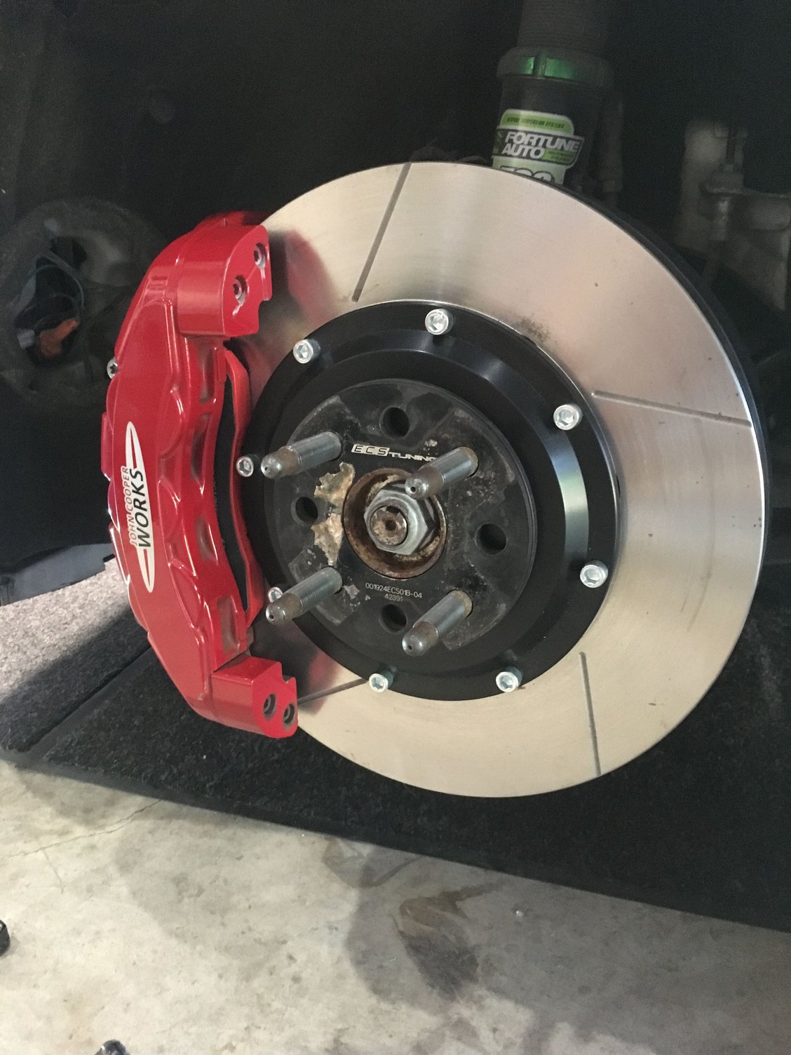

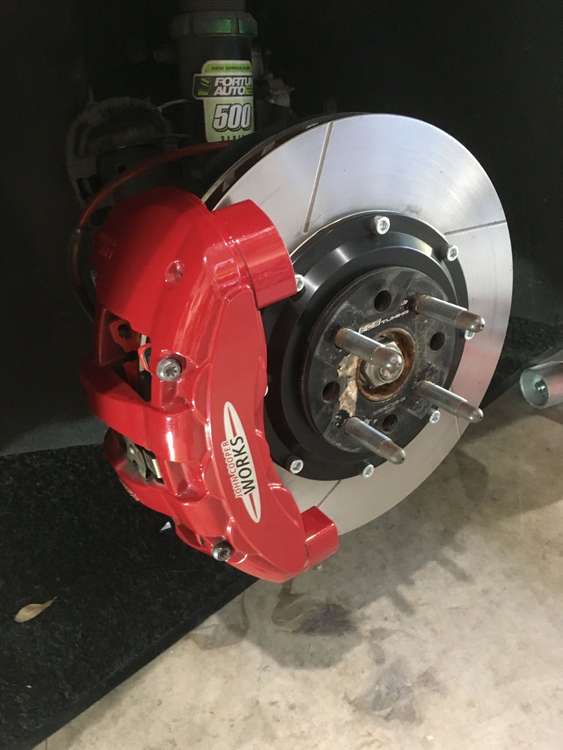

Last question. Are there lightweight rotor options for the factory 4pots?
Old Apr 23, 2020 | 12:43 PM
Posts: 36,762
Likes: 2,551
https://www.ecstuning.com/Mini-2013-...raking/Rotors/
Just cross drilled and slotted or slotted, might be marginally lighter due to material removed. In the future we hope to have some floating rotor options.
Cool thing if you notice on the back of the JCW and believe the GP2 rotor they have this smooth finish on the back of the hat to near the vein. Like its contours for air.

I had some lightweight two-piece rotors made for my GP big brake install. Much lighter than the stock rotors.
