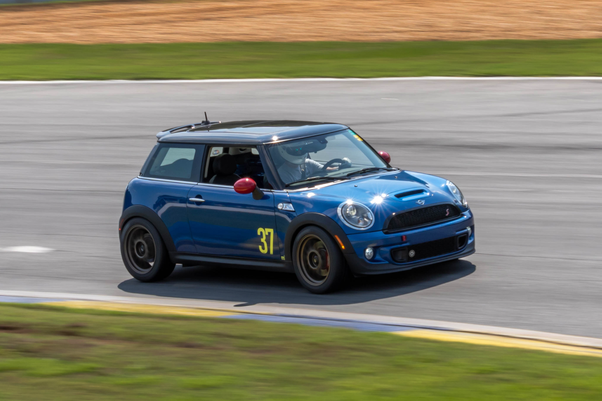

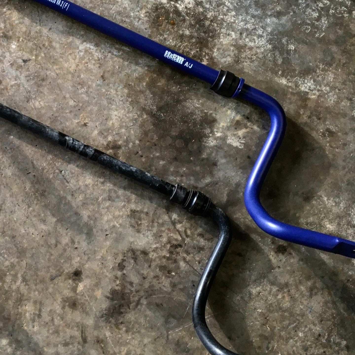

Scooted up to the ATL yesterday and snagged a H&R FSB from Way Motor Works. Pretty easy install. I also replaced my Madness poly bushes with Powerflex black and added some one of a kind Ireland Engineering front end links. First test drive this afternoon was great, the car felt very solid. Understeer was not an issue. I increased the Ireland Engineering rear bar to the stiffest setting and I think it really pairs well with the H&R. I have some track time coming up in July I’ll add to this then.

No LSD yet, but it’s on the list after cage, harness and seats.
I spent last weekend at Road Atlanta. Long story short, @WayMotorWorks knows what he is talking about. The larger front bar paired with a stiffer rear bar is the way to go. It did not induce understeer. It planted the front end and allowed me to pick up significant time on 1, 3, the esses, 5, 6, 7, 10a,10b, 11, and 12. Yeah, the whole damn track. It allowed me to carry more speed through the turns to set up better for the straights. I know no one wins HPDE but I was painting the bumpers of our Bavarian brothers and getting point bys all weekend long. I’ll do a full review later this week after I’ve finished going over everything on the car.

I spent last weekend at Road Atlanta. Long story short, @WayMotorWorks knows what he is talking about. The larger front bar paired with a stiffer rear bar it the way to go. It did not induce oversteer. It planted the front end and allowed me to pick up significant time on 1, 3, the esses, 5, 6, 7, 10a,10b, 11, and 12. Yeah, the whole damn track. It allowed me to carry more speed through the turns to set up better for the straights. I know no one wins HPDE but I was painting the bumpers of our Bavarian brothers and getting point bys all weekend long. I’ll do a full review later this week after I’ve finished going over everything on the car.
I have long believed a front sway bar on FWD vehicles was a good thing. Nice to see some track junkies singing their praises! Now I need to get one installed to my Clubman...
I'm glad you like it and see the benefit as there is too much neg stereotype about it rather than real feedback like this as most people don't do it or haven't even tried it.

I just installed a 27mm H&R front swaybar on my 09 MCS. I posted a how to video in the how to section if anyone is interested in the install. It’s not even close to being as hard as people make it out to be to install.
