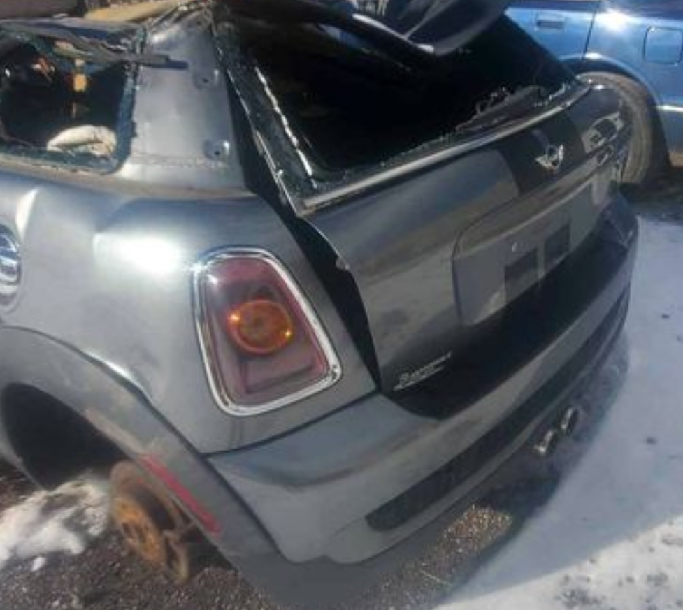

I am considering this upgrade and found a '08 parts car. The guy says the trailing arms are steel not aluminum and sent a picture that confirms it. Assuming he's looking at the right car which could this be? It's not a Clubman because it has a hatch. I just need to know what not to look for in a parts car if all are not aluminum. Thanks
Do you have the pictures of the trailing arms from that car? If its an R56, they should be aluminum.
This is an R56 so it has aluminum rear trailing arms, you also need the rear struts bushings to fit your rear struts into the new trailing arm.
That picture doesn't confirm anything, that's only a rusted brake disc hahaha
Yes, I know it is just a picture of a back end of a messed up car. Unfortunately I deleted the image of the trailing arm (still on the car) after he insisted it was steel. I'm a ways away from the car so I needed to confirm everything is good before making the drive. He had 1st gen Mini that we was parting also so I was thinking maybe he took a picture of the wrong car. But he stopped responding to communication so I need to keep looking.
