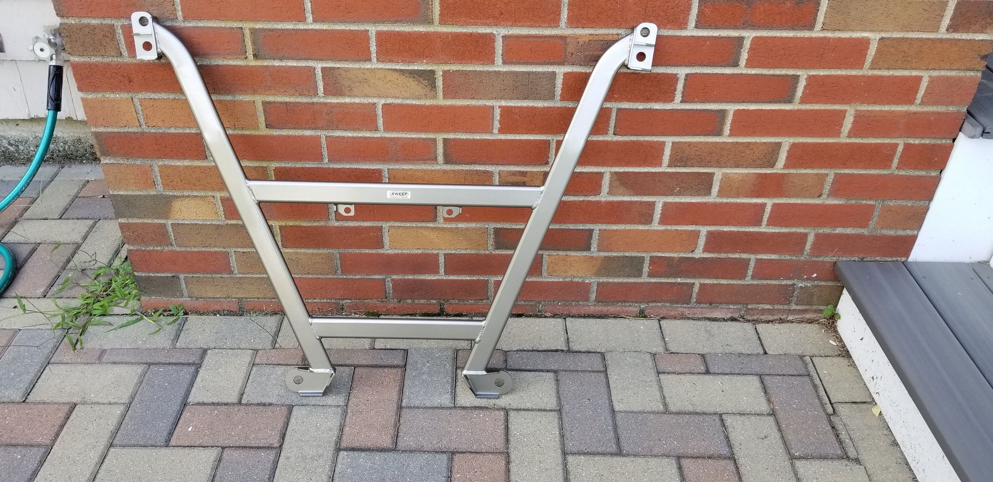

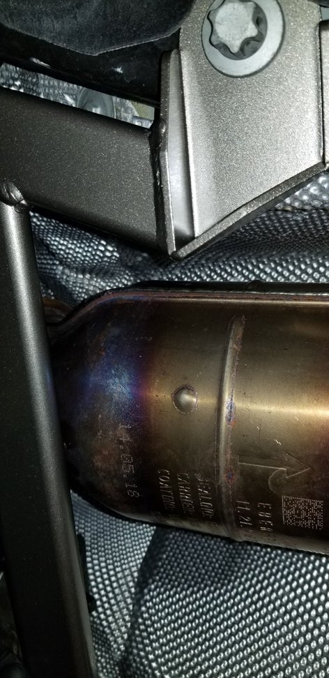

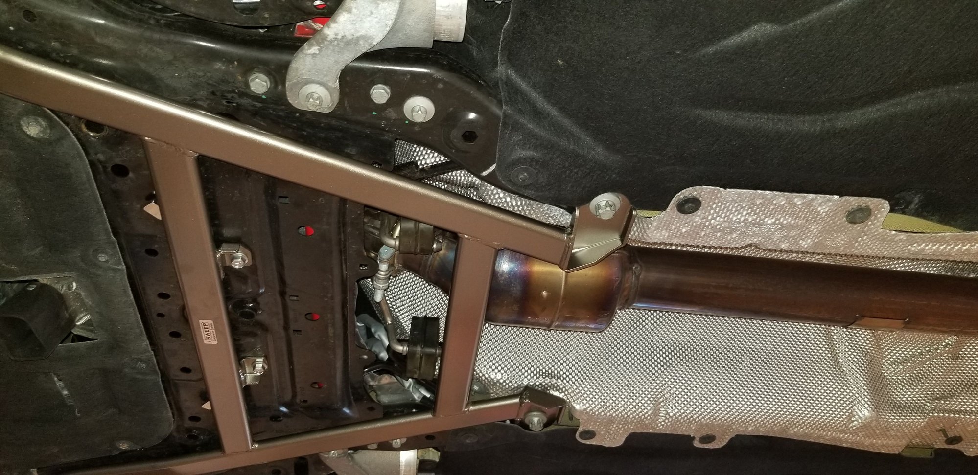

Had the dealer install it, way better than cardboard. Got it from the Japanese site, did not get the two tunnel braces (the mid one seems to only serve the floor from spreading) the rear might be a value tho. It's steel (confirmed with magnets). Unfortunately it interferes with the catalytic converter. USA models may have different Cat's than Japan. The dealer temporarily zipped tied the exhaust up (they checked with me first). I got this far so I had to try it. Car felt stiffer over bumps, can't tell yet in the corners. Total weight added 3.39 kg or 7.5 lbs: Brace weighs 3.15kg hardware difference 242gm. I tried reaching out to iSweep, see what resolution they offer. The pic are with zip ties and almost touches.

Oh man, that sucks!! Yeah if you look on the iSweep site, they have a pic of it installed, and indeed there is no cat there. Same as Europe I guess. Seems like if they designed it just *slightly* different it would have worked worldwide... bummer.
I'm sure an exhaust shop could easily remove that cat...
Or throw some stainless ties on the exhaust hangers. The ones used to hold header wrap on.

Apparently these are being sold in the USA without testing? I don't plan on modding the exhaust to suit an item that wasn't "correctly" designed. The exhaust vibration can be felt in the car now that the rubber hangers have been bypassed. Of course this will work for a car that had the cat deleted. I will take around some corners and see how it feels.

Its okay to delete the 2nd cat to make space, the dealership only cares about the primary cat if it throws a code. I removed my 2nd cat and the dealership didn't blink an eye.

you could do to a shop and get that part cut out. That is what I did back in the day. It was around $50
Disregard if you have emissions testing

I might remove the brace as soon as the zip tie fails. Vibrations being transferred into the car being that the rubber hangers are bypassed. Someone suggested shorter urethane supports, don't even know where to go for that.

Stiffer exhaust bushings might work... Maybe try some fender washers under the brace with longer bolts to move it out a bit? How does the bar feel, apart from the vibrations? Do you think its worth finding a solution?

It would have to dropped over 1" to clear the Cat. Car felt stiffer going over bumps, might need Auto crossing to realize the benefits. I haven't pushed the car that hard yet. I have feeling I'll be selling it, can't drive with zip tied exhaust.

I removed the zip ties & stock rubber hangers and installed Polyflex exhaust hangers (EXH032 & EXH025) so far so good i.e. no contact with the brace, well see if they start to sag.
