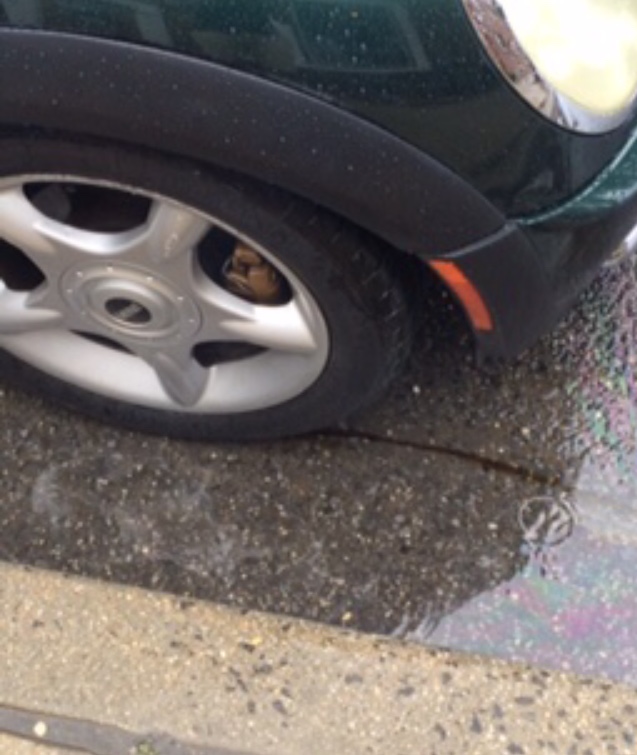

My little R50 looked awesome low. I just wasn't willing to blow the money on custom axles - I couldn't justify it with the car having as little power as it does. There are number of guys on here that have lowered their cars and have had little to no issues, I salute them. Combining my luck with NYC roads - I may be reverting everything back to factory or getting rid of the car this week. I can tell you one thing, while the picture below is funny knowing what was broken, it was certainly not fun....

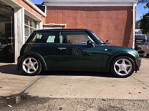

Here is a side view of mine with Megans with camber plates and added adj, rear suspension to be able to keep camber some what in check. I did run quite a bit of camber for auto crossing but was a 16,000 mile a year DD as well. Put these on at 40,000 miles and had to replace both axles at around 100,000 but drove another 60,000 without issue so can't say for sure that lowering was the problem of course.

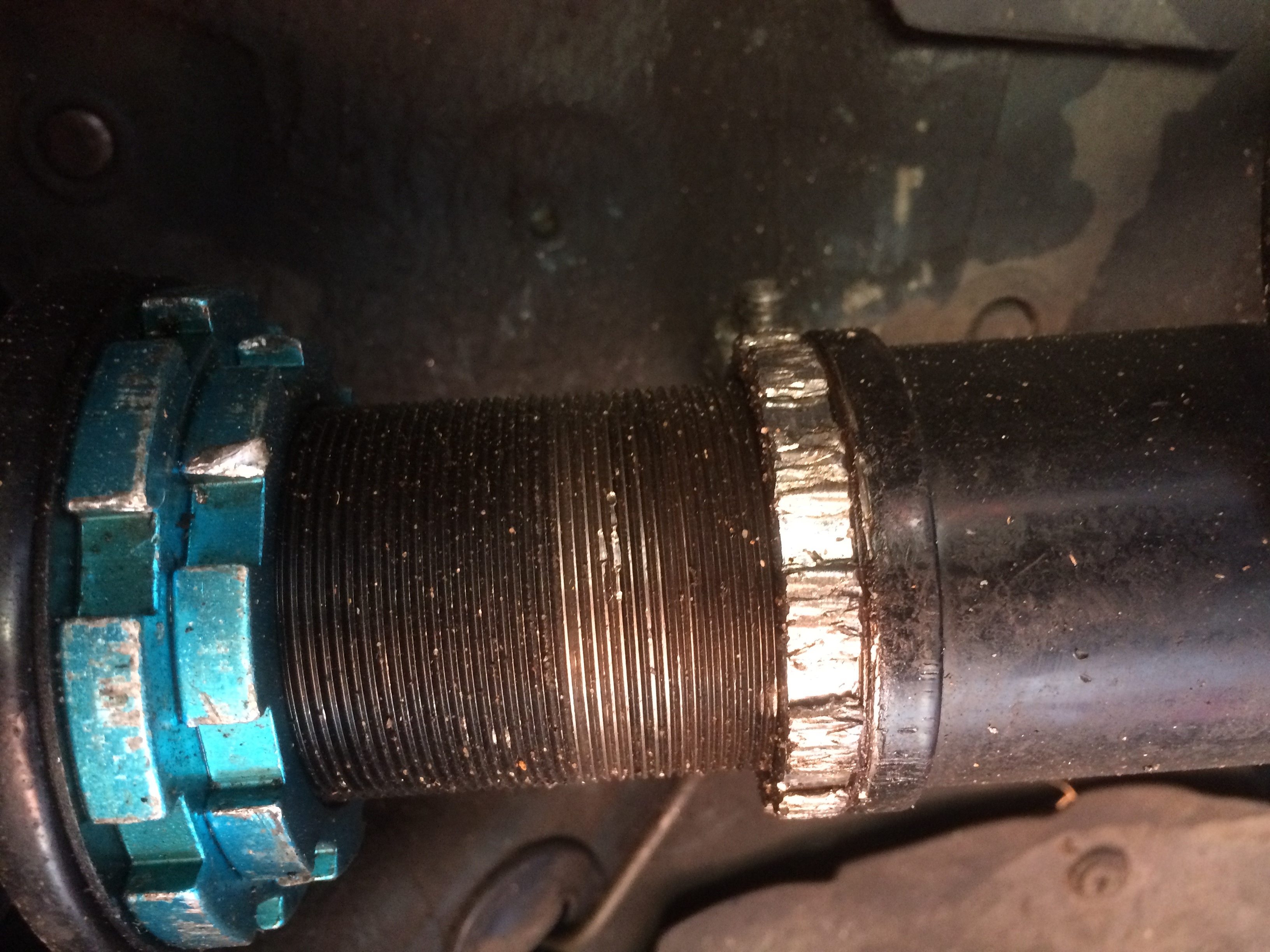

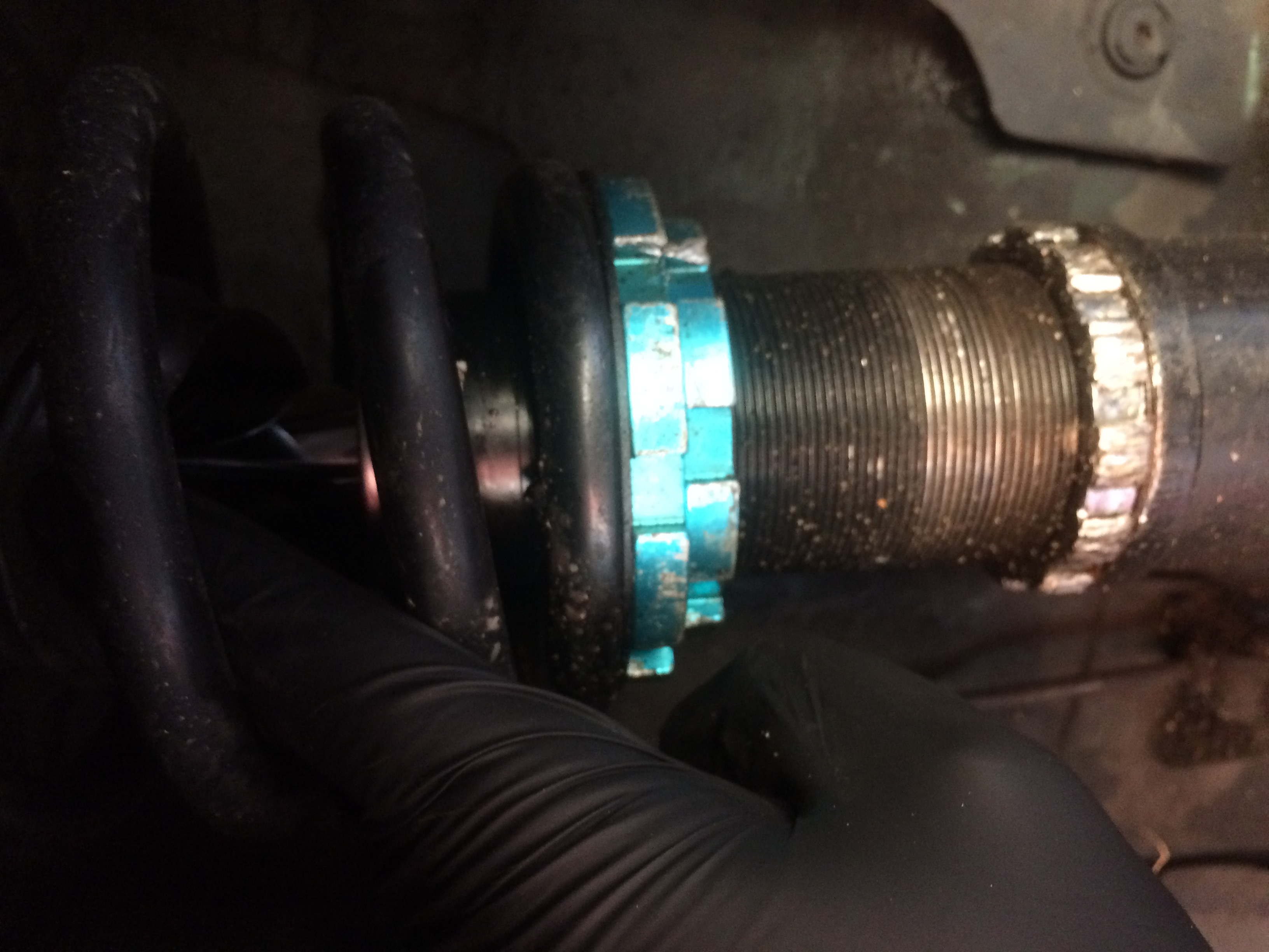

This is where the car is sitting now and where the coilovers are set. Even after soaking all four corners with just about a can of PB Blaster prior to adjusting - I managed to strip the shock body and destroy the locknuts. I won't make that mistake again....I bit the bullet and new coils will be going in this coming week, along with a 23mm rear bar and strut tower defenders (after getting them straight). I'll be coating the new set with boeshield or some marine equivalent if I can't find it.

I dont quite follow your first paragraph.. Are you saying you dont like the megans and wish you just did springs?
Wow, after how many miles did the seize up like that? When I asked megan about torque on those nuts, they said basically hand tight with the wrench, then a little tap with a hammer on the wrench to snug them up. Is it possible you over did it there?

I'm saying that by installing coilovers, I jumped into something that I wasn't very educated in. Suspension tuning. The Megans were on the car for a NY winter before I raised them to where it is. I really thought I cleaned them as good as possible but they were still extremely difficult to adjust. The lock rings seemed very soft to me to get damaged in the way that they did as well. However, a lot of people are running this set and have not had any of these issues so I definitely seem to be in the minority.
