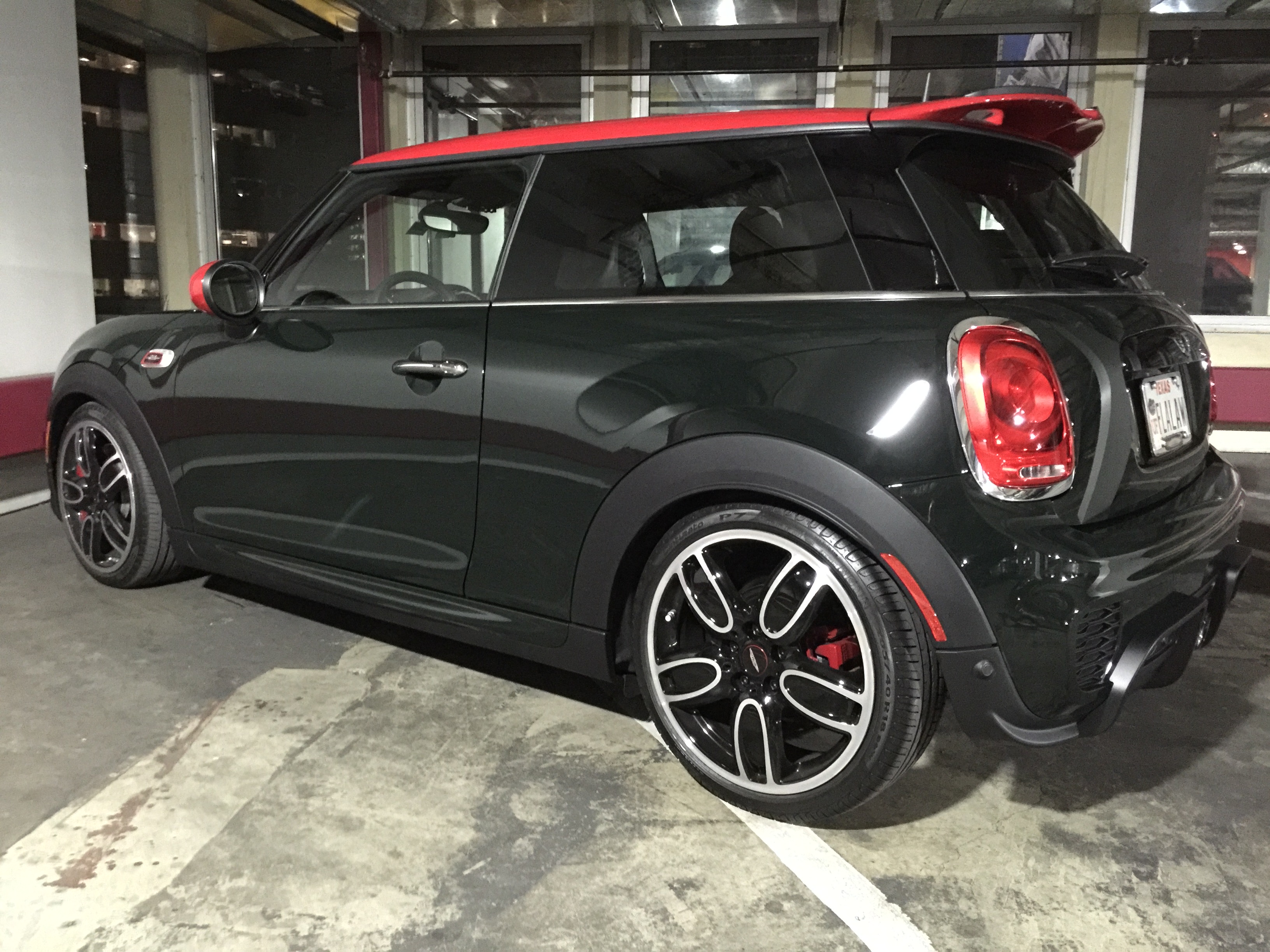

This thread definitely convinced me to go with the JCW Pro Suspension as well. This picture is from delivery at the dealership. I've got a little over 300 miles on the car now, and it's settled in nicely. Literally feels like a Go-Kart.....the handling is AMAZING and the stance is perfect.

Yeah - your stance looks very much like mine. I was there for the install, and it looks like we could have lowered it quite a bit more given the amount of thread still available, but I like where we landed.

Mine is all the way down in the rear (30mm) and the front is dropped to match the factory rake. I didn't want the front lower than the rear.....my R56 had H&R springs and the front was lower than the rear, and it bugged me the entire time I had the car. I feel like this is the perfect stance. I just hope it doesn't settle unevenly. So far so good though.....
PS: Are you running any spacers?
