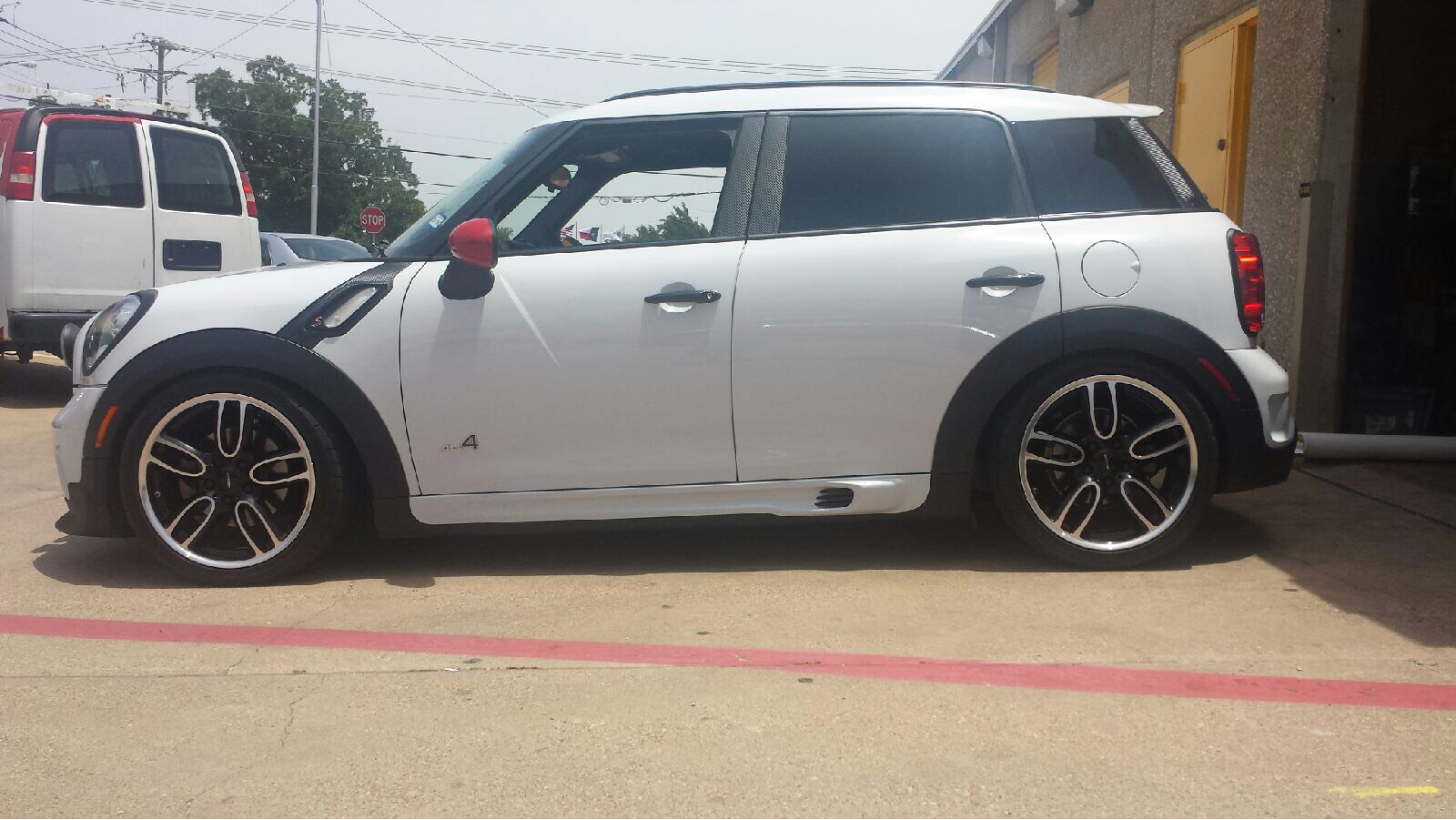

KW V3's Installed Today
Handles great!

Looks good. How do the they compare to your previous setup? I have the nm/billies as well and was thinking of going to the kw's.

They handle completely different. So much better. It is a different ride when you have springs paired with shocks. Night and day compared to the NM/Bilsteins but then again the price difference is huge also.

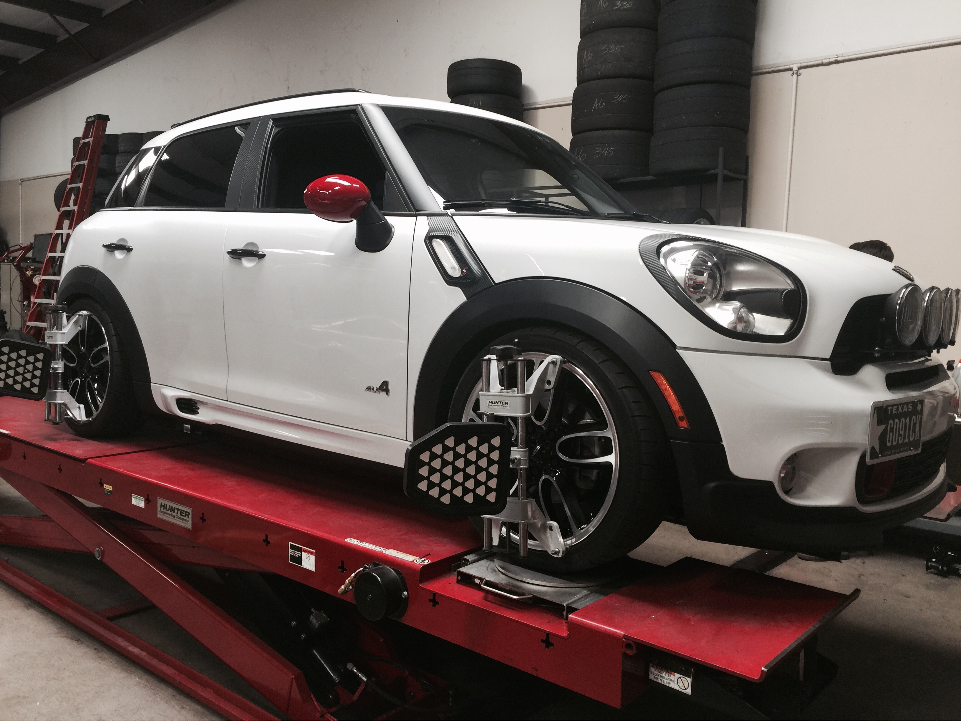

Photo from when I had them corner balanced and aligned.
