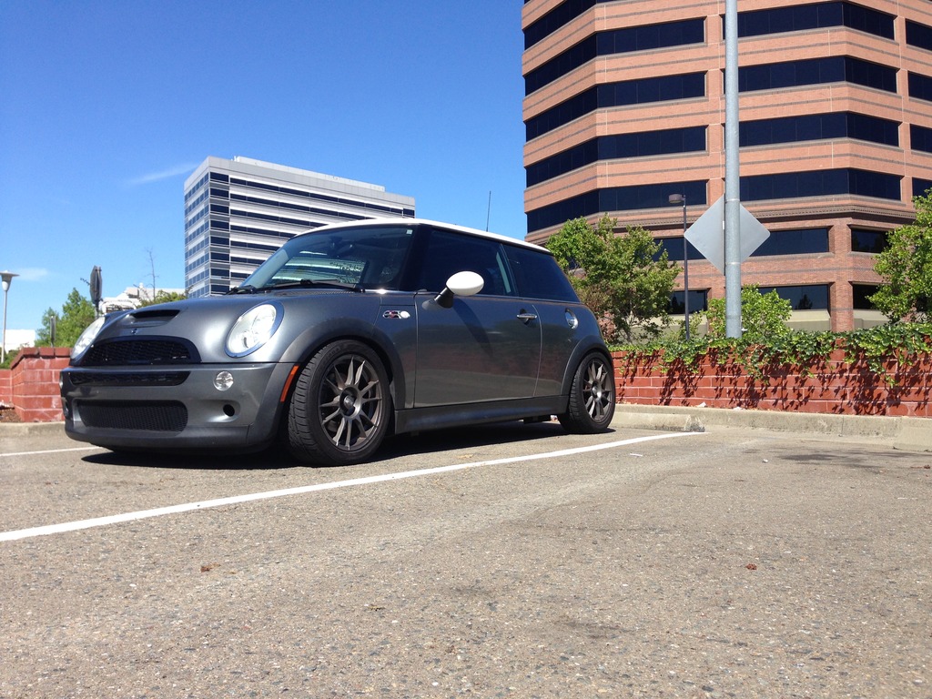

So front was after intalled and lowered, rear is stock height (Rear coils weren't installed yet) Just to see how low the front looked so I can pre-adjust rears before installing.
After everything got dialed in, here is how it currently sits (no side shots yet, iPhone had to be restored so i lost all pics from install day )
OVERALL: Super happy with how they came out. Wheels are 16" OZ Ultra's on a 205/50 (I think) tire... Might be going lower but new wheels soon so might just wait till those come in before I adjust height.
Install wasn't too bad, have never done suspension before and was told its pretty straight forward. So me and my friend, a 12 pack of brews and 6 hours later, everything was dialed in. Having the right tools from the get-go would've made this MUCH easier and less painful, but thats all a part of the process right?
Handling feels 10x better, and I can only imagine with a new RSB on the way and some real performance tires, how this will hold up at the track in a couple weeks. Would definitely recommend these coilovers for a good daily/occasional track day setup. If you're in the market though, go for the ones with camber plates as they're only like $150 more... I just got a steal on these from a local vendor that I couldn't pass up (Mine have no camber plates)

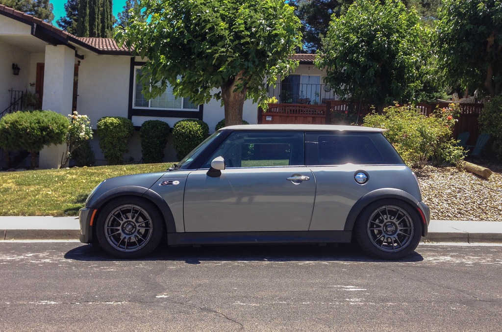

Side shot for anyone that cares

Old Jun 24, 2015 | 05:16 AM
daviday's Avatar
daviday
Joined: Feb 2014
Posts: 180
That looks great man. How would you describe the ride?
Old Jun 24, 2015 | 05:28 AM
N2MINI's Avatar
N2MINI
Joined: Feb 2007
Posts: 1,521
Likes: 17
Looks good. I have Megan's as well. The stock rear controls arms have just a tad of adjustment in them. Would like to see a rear view to see how much neg camber you now have. Might need to invest in a set of adj control arms before long to help save tire life..
