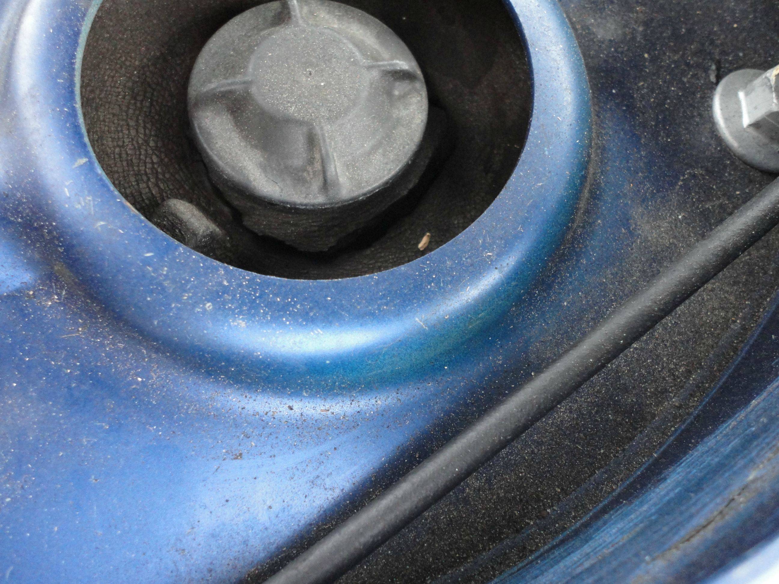

The front clunk can be from the outer tie rods to the inner ball joints. I would also check those upper strut mounts for cracking. They will tend to get circular small crack that open up.
https://www.northamericanmotoring.co...-toy-ever.html
For the tie rods and ball joints. Some hints and trick on the ball joints and tie rods.
https://www.northamericanmotoring.co...ll-joints.html
Good luck.

Strut mounts were replaced at the time of the shock replacement . Thanks for all advice and balljoint info . Ill check in when a fix has been found !
