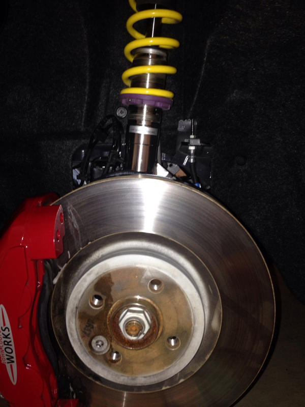

Installed KW V2's on GP2
Took me awhile to figure out what Coilover system to replace my stock Bils/H&R GP2 Coilovers. I wanted a system that went lower and rode nice because this is my daily driver. I chose the KW V2's and I love them. Easy to install and set up, but I am going to go with some custom SWIFT springs next month. Here are some pix. I do admit the front CF lip can make it challenging to get out of my own house)

FYI our TSW spec KW's V2 come with custom linear springs on them, that could have saved you the trouble of taking them back off and the expense of buying more springs.
Watch out for those a-corns!
What rate (and length - 7"?) springs are you after?
I assume fronts only, since rears (8" long 230 in/lbs) are on the stiff end of TC Kline (renown BMW/MINI race shop) recommended setup: http://www.tcklineracing.com/webdocs...Details689.cfm
a
P.S.: IIRC, Way also plays with KW spring rages, but doesn't tell anyone what his preferred setup is.
P.P.S.: I have a set of KW v3s ready to go on the car, though I wont dare go that low on NJ/NY roads.

Watch out for those a-corns! What rate (and length - 7"?) springs are you after? I assume fronts only, since rears (8" long 230 in/lbs) are on the stiff end of TC Kline (renown BMW/MINI race shop) recommended setup: http://www.tcklineracing.com/webdocs...Details689.cfm a P.S.: IIRC, Way also plays with KW spring rages, but doesn't tell anyone what his preferred setup is. P.P.S.: I have a set of KW v3s ready to go on the car, though I wont dare go that low on NJ/NY roads.
Not quite sure what Swift springs I'm going to pick, but they will be more on the
Sent from my iPhone Office
Not quite sure what Swift springs I'm going to pick, but they will be more of a Daily Driver set up. Girlfriend friendly!

I thought standard KWv2s came with the wider, progress rate springs up front? Your pics show the constant diameter springs along with the helper springs.
Way, can you confirm?

I thought standard KWv2s came with the wider, progress rate springs up front? Your pics show the constant diameter springs along with the helper springs. Way, can you confirm?
I think you might be right. I called KW about my V2's and they told me the fronts are progressive at 299lb and ride height. I wonder why mine don't have that tapered look?

Progressive springs don't have to be tapered. Coil winding distance just isn't uniform.
Yes the KW V2s from KW or any other online site come with progressive springs.
The ones on our site are the smaller constant diameter because they are linear.
What is on this car I can't tell ad we can't see the top of the front springs.

Originally Posted by WayMotorWorks
Yes the KW V2s from KW or any other online site come with progressive springs. The ones on our site are the smaller constant diameter because they are linear. What is on this car I can't tell ad we can't see the top of the front springs.
I will take better pix and try to get some numbers. I wonder why mine are different?
I did buy them used, from and the guy just told me he purchased them from Way Motor Works. So the question is, do you change both the front and rear springs? So if I want something more DD and cushy, should I try a different springs?
Thanks and mystery solved
Mario
Those are definitely linear springs with a helper, so they probably are Way's version.
IMO if you want something more DD and cushy, you should raise the car because you are slammed too low for ride and handling.
- Andy

Originally Posted by andyroo
Those are definitely linear springs with a helper, so they probably are Way's version. IMO if you want something more DD and cushy, you should raise the car because you are slammed too low for ride and handling. - Andy
The car rides better than the stock C/O and handle incredible. No bump steer and alignment. Is near perfect.
Good to hear. KWs are good stuff. It would get better with a little more ride height and I don't know that changing springs would have as much of a difference in comparison.

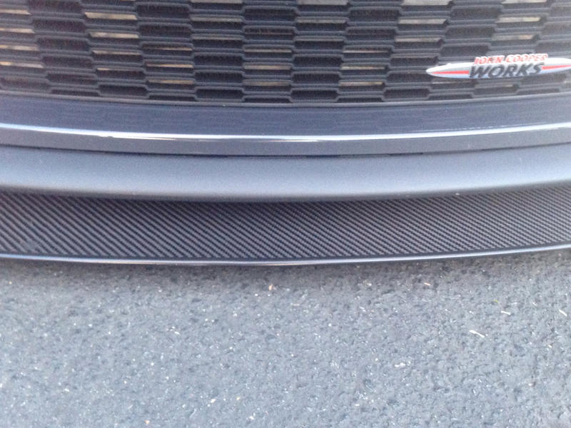

Good to hear. KWs are good stuff. It would get better with a little more ride height and I don't know that changing springs would have as much of a difference in comparison. - Andy
It's damn low!!

Originally Posted by squawSkiBum
How do you adjust the rears? Did you drill holes at the top so you can get to the adjuster?
The fronts are 18 adjustable from the top, super easy. I didn't drill from the top for the rears and KW doesn't sell a remote style coil. I played with the front and back height, and rebound/comp for three days. I think I had the rear Coilovers completely in and out close to a dozen times. I have become very good and removing the rear Coilovers, got it down to 18 minutes. ). Since I don't track the car, I don't see a need to adjust them anymore
Thanks Mario
