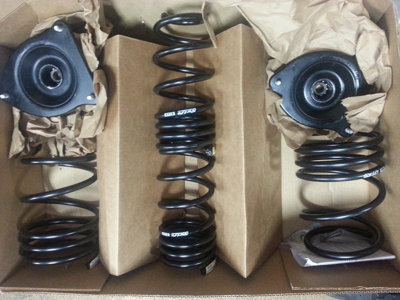

I just installed my new strut mounts and spec rs tonight. The rears were a piece of cake maybe 25 mins a side. The fronts right took 50 mins the front left took 2 hours it was my first one and it was stuck in the knuckle. So it was a pain.
But I would uave to say they feel amazing my wiggle in the steering wheel is g9ne from the new strut mounts. But the handling feels alot better. The only thing is on a 55mph back road it felt a little wavy. May hace been the road and the firmness but I felt like the front would lift then go down as the back came up just like a wave
You can feel the firmness but its not to bad. It feels more planted as well. I have stock shocks\struts and it is not a bad ride what so ever.
Also the drop is perfect not to much not to little it looks great. I will post pics tomorrow of the drop its dark here right now.
Attached Thumbnails Swift Spec-R Koni Sport Ride Height - Pics Inside-20130412_144652.jpg

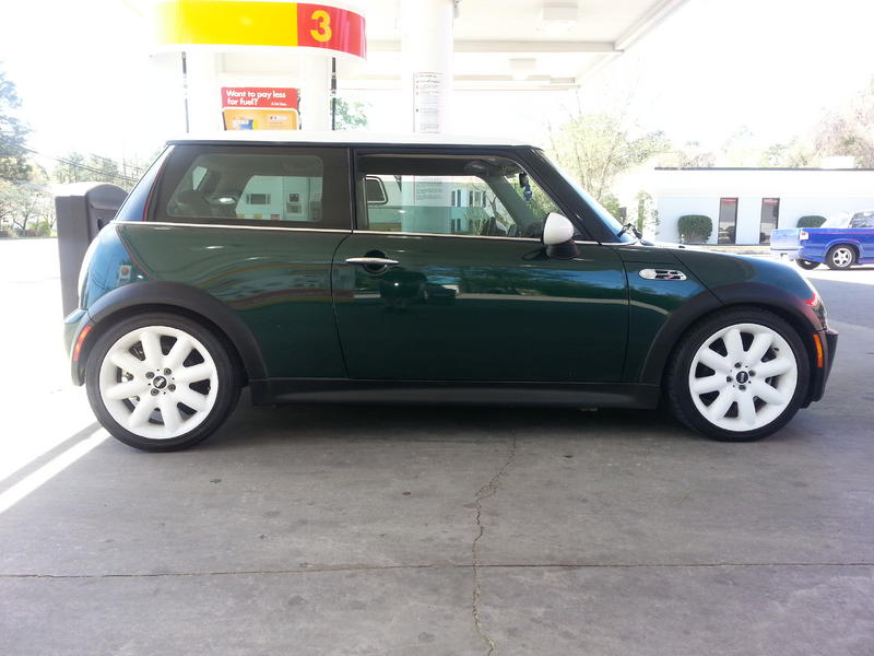

Quick pic while I was getting gas today. They feel alot smoother on the highway
Attached Thumbnails Swift Spec-R Koni Sport Ride Height - Pics Inside-20130413_113552.jpg
