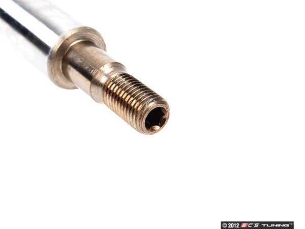

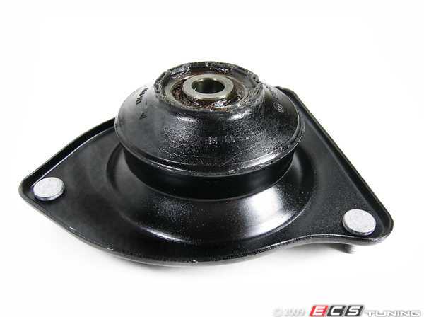

Do you have pictures of the strut connection? You did not give me the production month / year of your MINI.
Top of strut.
Bottom of strut mount.
If that helps.
Top of strut.
If that helps.
Its a 2003 mini cooper, and those connections pictured are correct. I was talking about the strut, and knuckle. It was in the knuckle about 1/2". I drove the car to and from work today, got home, and the strut was a little loser in the knuckle where I could get it out, replaced the mount, but couldn't get it down in. I got a hammer, and beat the crap out of the strut to get it down all the way. Also had pressure with the jack to help.
