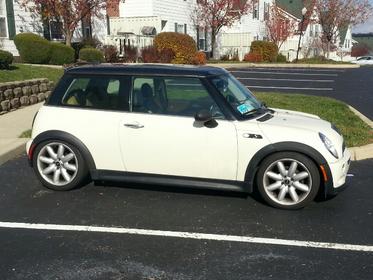

VMAXX will put you on the floor. For reference: my R53 front: 1/2 way down. Rear: 3/4 down. Megans offer much more adjustability. For the price, I couldn't pass up VMAXX since I do love the low life problem is I have 3 sets of speedbumps coming into my apt complex so this is as low as I can go until I move
Edit: ugh the app shrunk my photo...again...my rear tires are tucked and the front have less than 5mm gap.
