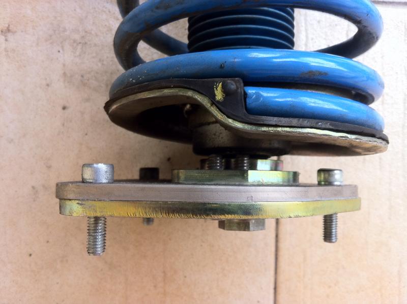

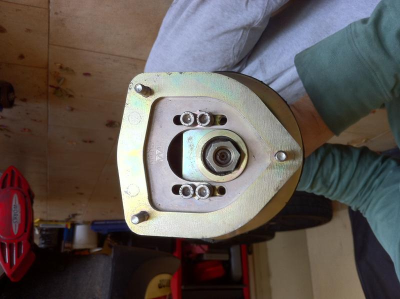

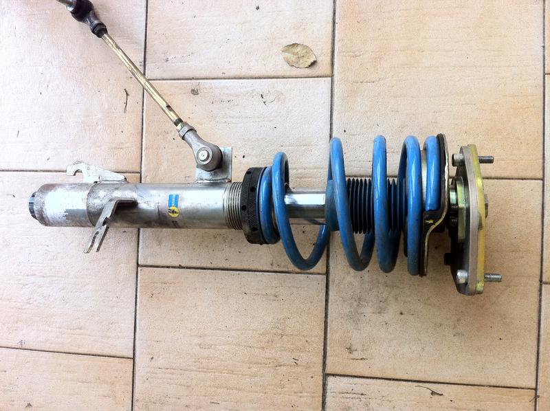

Hey guys,
I've been trying to figure out why my Vorshlag plates aren't allowing me to to get more than 1.3 deg of neg camber up front. I thought maybe that the plates were installed wrong (left to right). But there is nothing on the Vorshlag plates that says which goes on which side.
I took some photos of the plates as they are on my PSS10s. I'll attach them here. They are of the right hand side coilover and camber plate. The left hand plates have actually been touching the perch, as there are tiny dents on the perch. This can't be good.
Thanks in advance
Attached Thumbnails Only 1.3 deg neg camber with Vorshlags-rhs-1.jpg   Only 1.3 deg neg camber with Vorshlags-rhs-5.jpg   Only 1.3 deg neg camber with Vorshlags-rhs-3.jpg

I may be wrong but it looks like there are two more holes farther back for the adjustment bolts to occupy. If you move the allen bolts to the right and occupy the vacant holes I think you'll achieve more neg camber.
Edit: NVM didn't realize the the spherical bearing was there stopping any further movement at first glance.

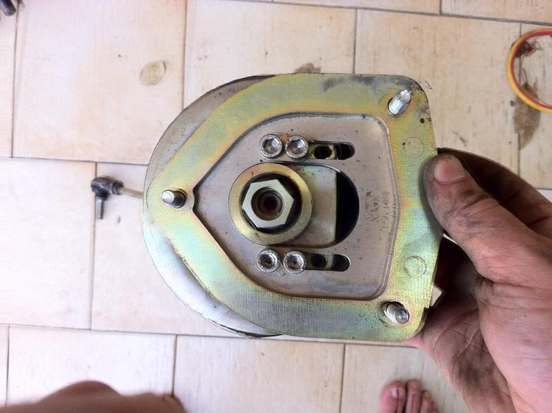

Yes, I have considered moving the bolts to the next set of holes, but as Creeve mentioned, the bearing limits the movement, so even if I changed the bolt holes, it would stop half way.
Edit: like this

Ok given the bolt pattern the only way you can tell a right from left is by the stamp in the plate. The stamp goes to the outside of the car. (It shuld be marked.)
(I know its UPSIDEDOWN)
When mine where first installed they looked like this through the shock tower hole.
After the trimming they look like this.
If you are totaly out of adjustment and everything is installed correctly, it might be because the coilovers you are using have OEM sized springs/perches. The whole assembly moves not just the plate and with the springs being that big it would be easy to run out of room in the shock tower. Here's a comparison shot of the differance between OEM and the AST's I use, to show the differance in the spring size. Hope it helps.
Edit: like this
Ya I noticed that too after my first post, sorry about that.

I'm just not sure that they are installed properly, as there are dints on the perches.
Are their left and right plates, and if so, how would I know? All they say are "OUT", but that doesn't tell you anything.

When they are on the car do you have the full range of motion?
If not it's deffenatly the spring size, which would also explain your dented perches. Also the ride height will play a part in how much negitive you can get, lower means more in most cases. If you are setting the car up close to stock height you wont get as much. It's just the little things you have to keep in mind.

The perches are made for the Bilstein PSS10s, surely they aren't meant to dent?
I'm pretty low, probably around 40-45mm lower than stock. Should be getting twice as much camber I'd have thought
