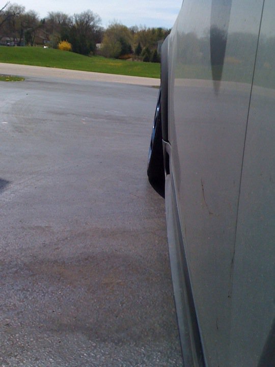

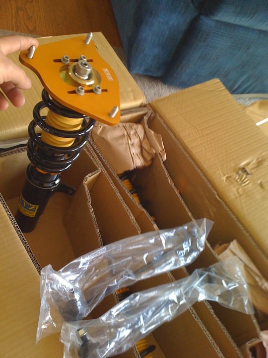

Heres some pics of the coils/how low he was

Rear Camber

When you lower a mini you do risk breaking front axles (CV joints mainly), due to funky angles of the joints, depending on how low you go. Also, in the rear you can get crazy amounts of negative camber... again depends on how low you go...
Certainly there will be more stress on the car when you lower it. But I haven't heard of much more than broken CV's and crazy rear camber that can be associated with lowering. Rear control arms to control rear camber and CV axles are fairly inexpensive (~$200 for control arms, ~$100 for each axle). A lot of people have lowered minis... it's just one of those things that you have to figure out if you outweigh the benefits over the risks...
