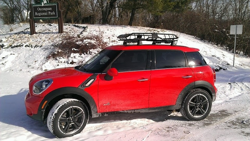

Just getting back on line after quite a while.
BF...Great looking MINI!
WWT...I have over 20,000 miles on the tires that went on same time as the list and no wear issues with routine rotations.
Also, put some new winter tires on the original OEM 18" rims and been getting thru these crazy winter storms just fine.
No rattles or issues with suspension with the lift over the same time/mileage. Looking to add a bigger rear sway bar this spring and front strut tower brace to try and tame the bit of the roll and push that going up instead of down has created.
Here is the latest pic.
Please keep posting photos of any of your lifted MINIs!

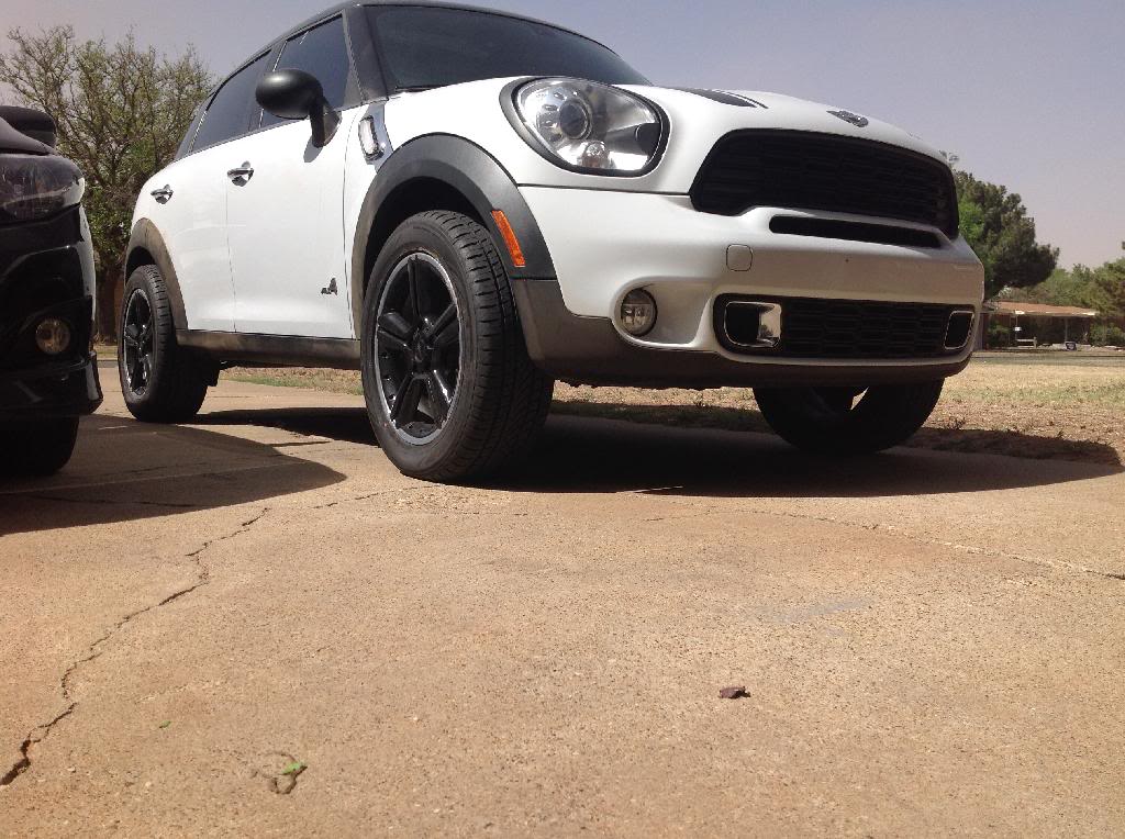

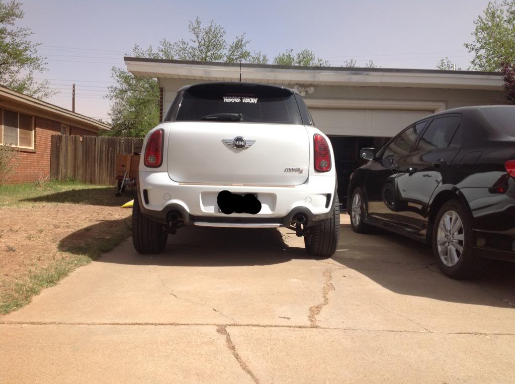

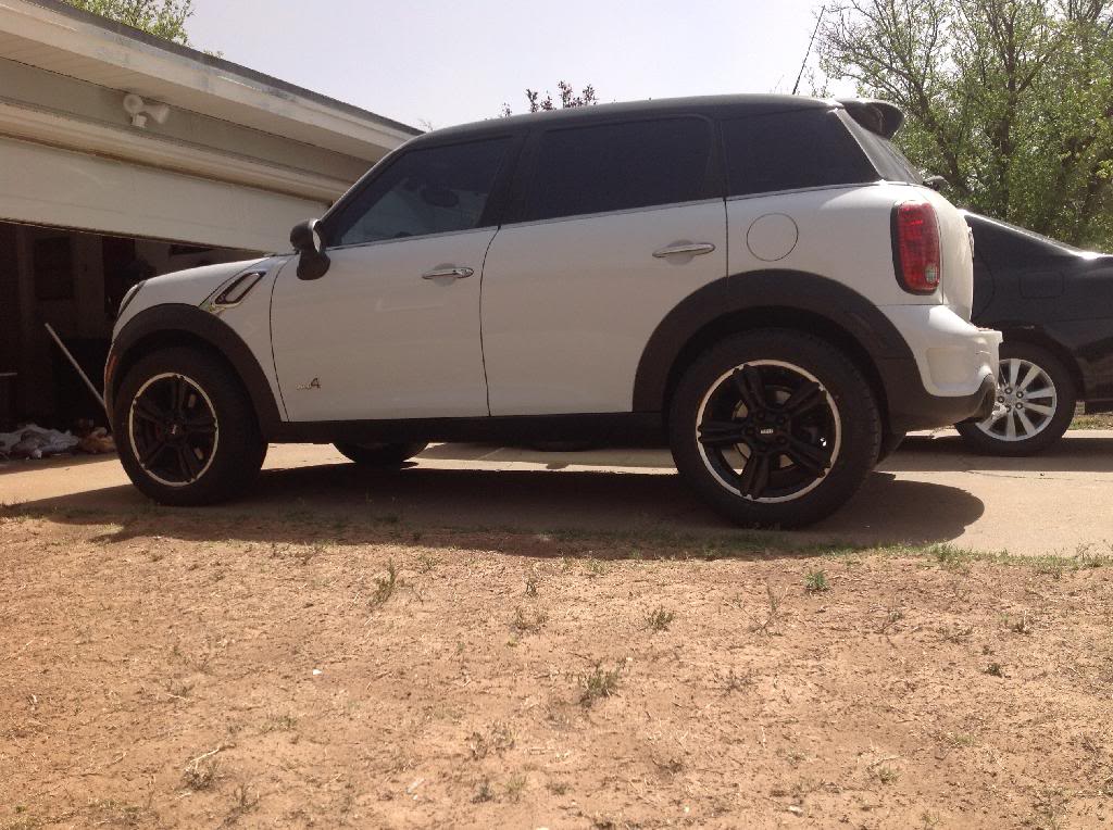

Just finish lifting my Mini monster.
Running 2 in lift from cooper crap with 235/55-18 tires.
No rubbing. Had to get 20mm spacer though.

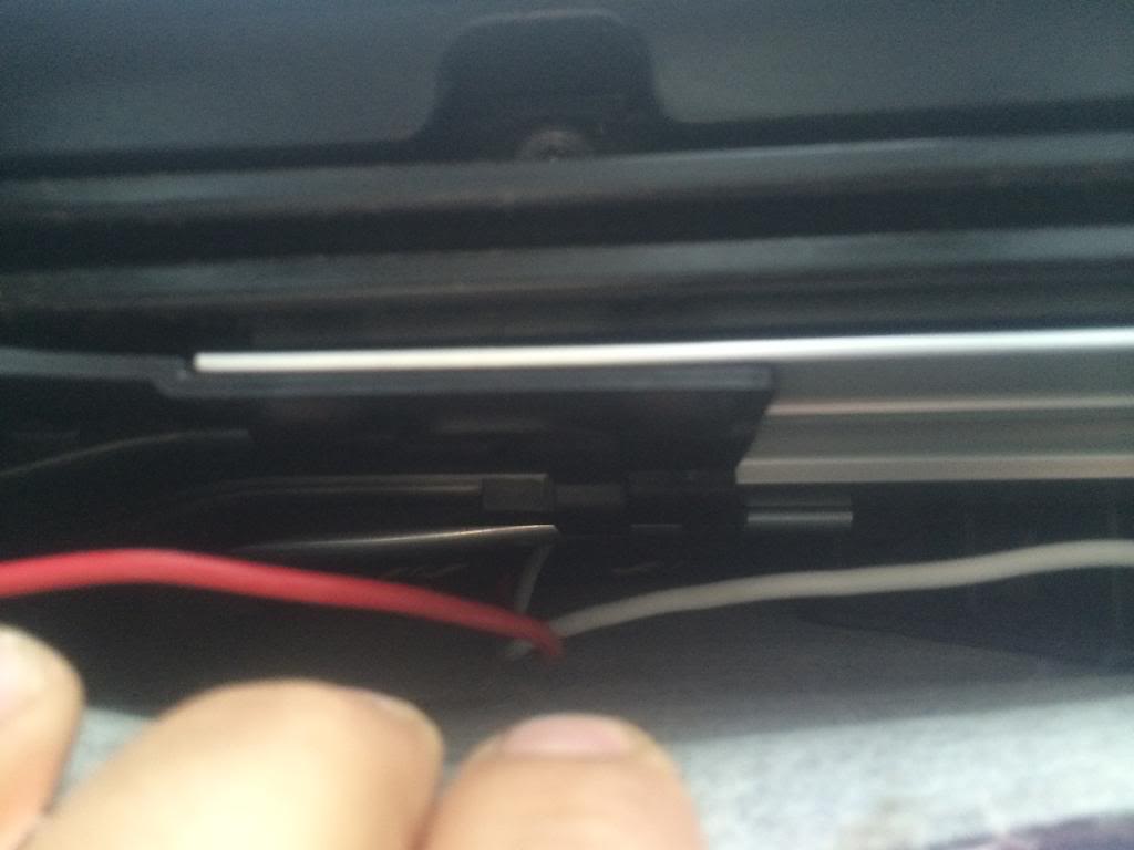

Wiring
So I ran the wires inside the roof basket to get a clean look.
Then made a small connection on the side of the roof rack. (Super small and easy to disconnect if I wanted to take the basket off.
Ran the wires under the headliner.
To this switch. (Main power from batter so the lights would work even if the cars off. )
On a side note I washed my car yesterday and there were no leaks. ( that's why I haven't put the headliner completely back together. )
