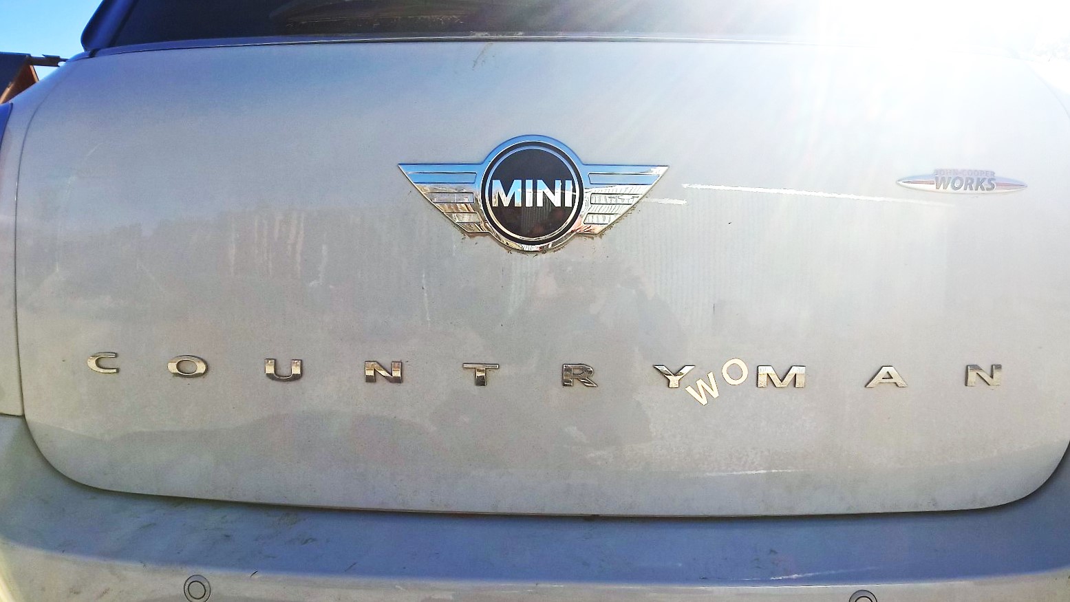

My wife wanted more clearance in her JCW CM, but after the suspension shop said they couldn't install the Crap lift kit due to lack of space for the spring compressors, I took the project on myself. Three days later with the car on jacks in the driveway, the lift kit is in and drives better than expected on the corners. Also replaced the Pirelli Runflats with slightly oversized Michelin Pilot A/S 3 (225/45 19R) which helped with the handling.
And now the job is complete with this modified badge.
